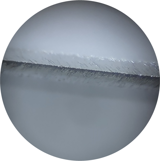

Here's an image I managed to capture through my 30x microscope of the blade of C75 steel I'm practicing on. The blade is sharp enough to very easily shave hair on my arm, but is not "tree-topping" sharp, and is not getting sharper. The number and size of shiny spots is not reducing. (There is no burr visible through the microscope.)
Am I at the limit of apex fineness that can be achieved on this blade? Or should I be able to get this knife sharper if I can get a more refined apex on stones before hitting the strop? The last stone I use before hitting the strop is a Norton Ascent ultra fine ceramic stone.

omg this is a 30x image and from here already we can tell that the apex isn't sharp. i posted 100x images on the forum somewhere and even at the higher magnification the apex should look like a clean straight smooth fine line.
i wouldn't strop this rough apex but spend more time on the stones to refine it.

I have discovered that a line of closely-spaced, tiny bright spots on the apex when viewed under 30x may indicate a micro-burr, even if you see no overhange. This will be accompanied by a significant reduction in sharpness. With the K55K in C75 carbon steel, three-to-five consecutive light strokes on the side over which the burr overhangs will clean it up and bring back the sharpness.

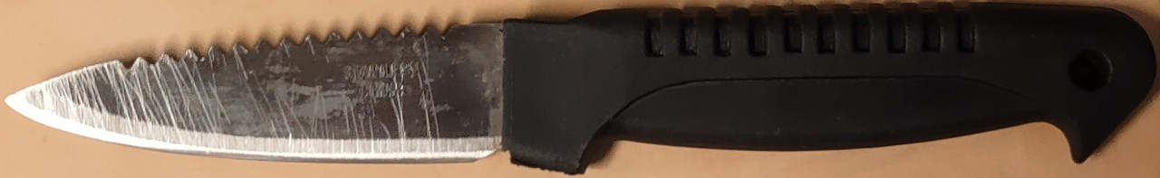

Getting closer to my goal of tree-topping sharpness. This little "gem" is almost there. Say hello to the sharpest knife presently in my home!
Ain't she a beauty? :D
I think I paid $2.00 for her when new, and even that was probably too much. She's stained and scratched up. Lighting gives a false impression of bevel shaping, but the bevels are still quite bad. I hacked away some of the blade's heel to make the knife easier to sharpen on my DMT stones, which have small margins along the long edges where there is no abrasive. I did some crappy re-profiling to significantly reduce bevel angle to, I'm guessing, somewhere between 10 and 15 degrees per side. Need more practice on that, my hands kept trying to do a ~20 degree angle. This was a quick-and-dirty, destructive experiment to determine whether a soft steel would limit the sharpness I could attain. Looks like the answer is "no". Or, put another way: It's not the blade, it's me.

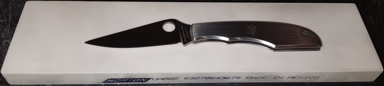

Many, many hours and knives later, I've finally brought a knife to tree-topping sharpness.
Knife: Spyderco Grasshopper
Steel: 12C27 Stainless
Bevel angle: Whatever came stock on the knife. Quite low, whatever it is.
Equipment used: DMT DiaSharp coarse, DMT DiaSharp fine, no-name fine ceramic stone, Norton Ascent ultra-fine ceramic stone, Sharpal green compound on unknown wood (Home Depot paint stirring stick), 0.5 micron diamond compound on basswood, 0.25 micron diamond compound on beech.
Target sharpness was reached on the Norton Ascent ultra-fine ceramic stone. Subsequent honing compounds further improved the edge but weren't needed to meet my goal. I've not yet used a leather strop on this knife. I plan to try a few strokes on plain leather to see if the edge improves further, and will abandon use of leather strops entirely if I see no improvement.
Major observations:
* Maintaining a consistent angle is extremely important
* My fingers feel burrs far better than my eyes can see them. I need glasses...
* Burrs can be difficult to see even under magnification
* Burrs can exist even when I can't see or feel them
* I should not move past the DMT fine stone, or any other hone higher up the grit sequence, until I feel no burr, see no burr, and have done a good number of alternating strokes to ensure that whatever burr remains is as small as possible.
* Ultimate edge sharpness is highly dependent upon the level of perfection I achieve on the DMT fine stone.
* Hones and strops are very limited in the degree to which they can improve a poor edge left by a lower grit.
* My best results are obtained when I don't try to rip off a burr (run the edge across some wood, or run the edge down the stone at an elevated angle) until the very end of the sharpening process, if at all.
* The repetitive motions of sharpening can lead to dangerous complacency. Pay attention! I cut my wrist while bringing a knife closer and turning it edge-up for close inspection. I was very lucky I didn't seriously injure myself. The scar left behind serves as a reminder to be mindful every time I see it.
