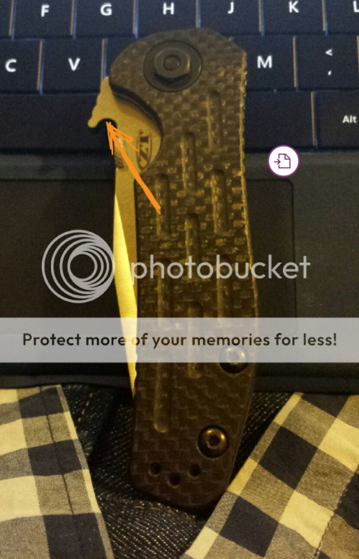

Draw an imaginary line from the pivot to the thumb stud, push the stud perpendicular to that line, this transfers the force most efficiently.
That angle doesn't work in my experience. I've been carrying the 0620CF daily for nearly two months now. This is the angle that works for me:
