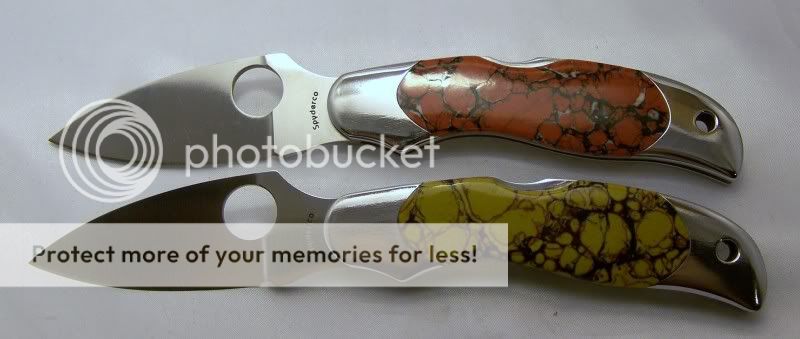

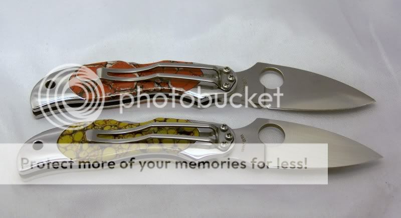

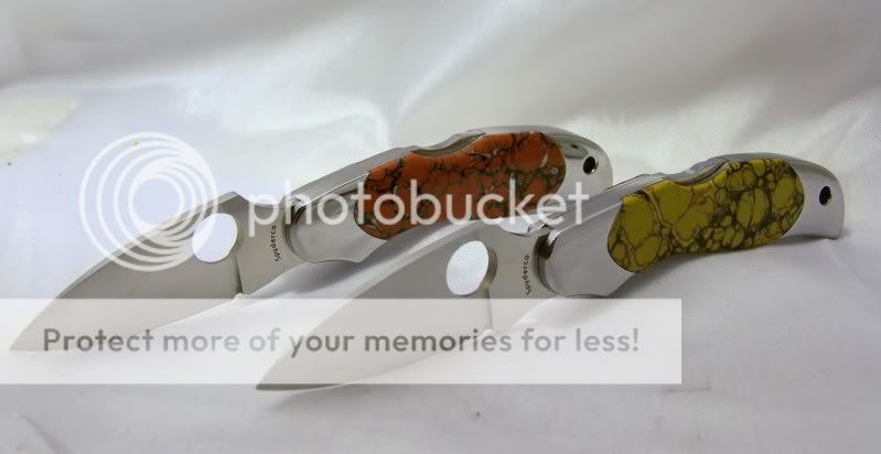

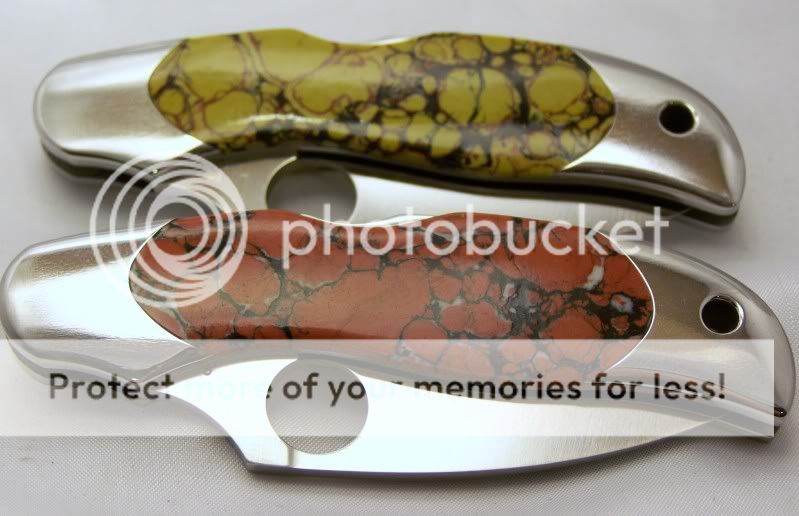

i just finsihed these, thought you guys might want a look:)
Red & Yellow Dino Bone

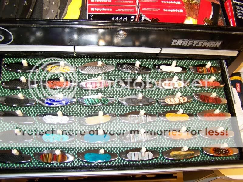

and a group shot of the kopa drawer, not the best but i cant get high enough with the basement ceiling to take a better one.
That is beautiful Tony. Excellent work, this is a full on passion in you now isn't it? I remember reading on the Spyderco forums a when you started the Project Kopa. Good to see someone doing something they are passionate about.
A little OT: I've been meaning to ask you since you gave us a peek at your Endura drawer, are those dowel rods in the drawer olding the knives in place? Could you share how you did that? Thanks!
Very nice work, Tony:thumbup: They look great.
I too use the craftsman tool chests for knive storage. The shallow drawers are perfect for knives.
thanks guys. as for the dowels, i use some plywood then layout where i want the dowels. cut the wood about 1/2"-1" short of the drawer size. drill about half way into the wood. cover with some colored paper (mine are file holders). make an X cut where the dowels are then put that tool drawer stuff down (i cant think of the name of it). i pull it tight and hammer tack the edges. hammer the dowels into place and that is it.
thanks guys. as for the dowels, i use some plywood then layout where i want the dowels. cut the wood about 1/2"-1" short of the drawer size. drill about half way into the wood. cover with some colored paper (mine are file holders). put that tool drawer stuff down (i cant think of the name of it). i pull it tight and hammer tack the edges. make an X cut where the holes are. then hammer the dowels into place and that is it.
Awesome collection Tony! :thumbup:
The Dino Bone Kopas are amazing! They're a great little knife. :D

Brilliant system. I'm going to give it a shot. Anymore Kopas in the works? Maybe one with some Turquoise/Red Coral? Hmmm? lol
