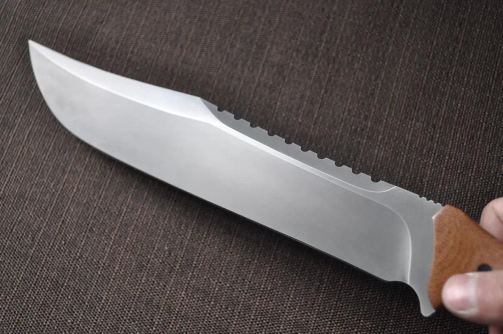

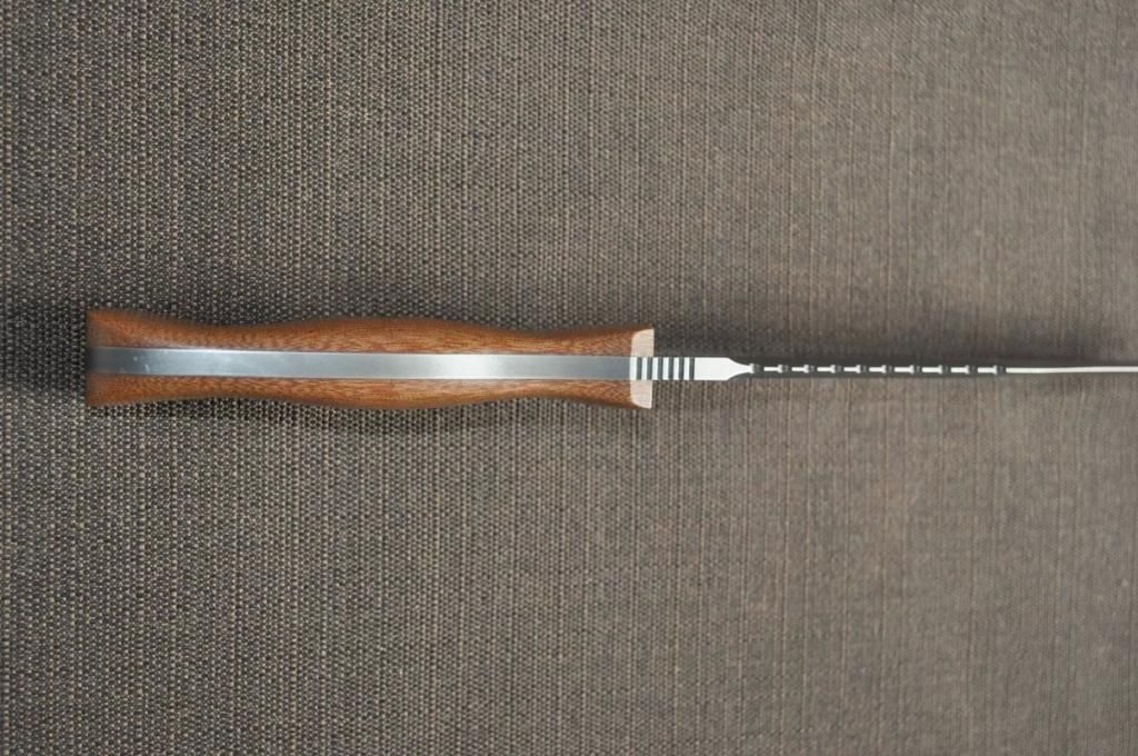

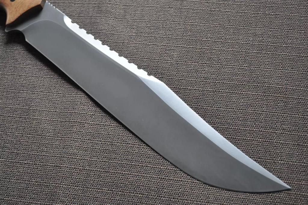

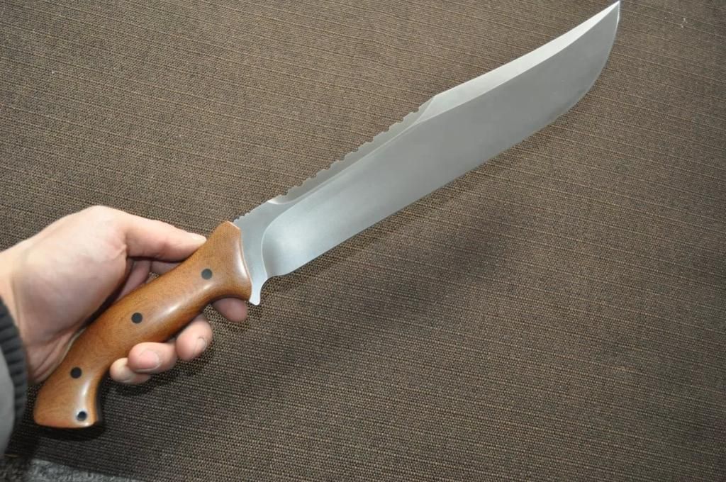

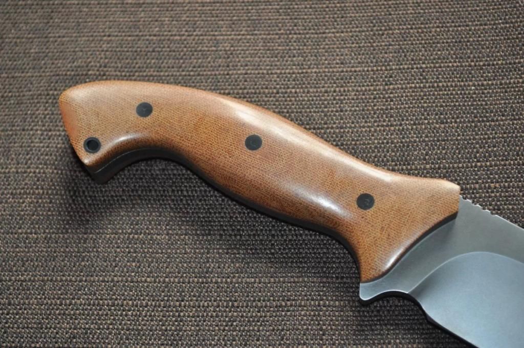

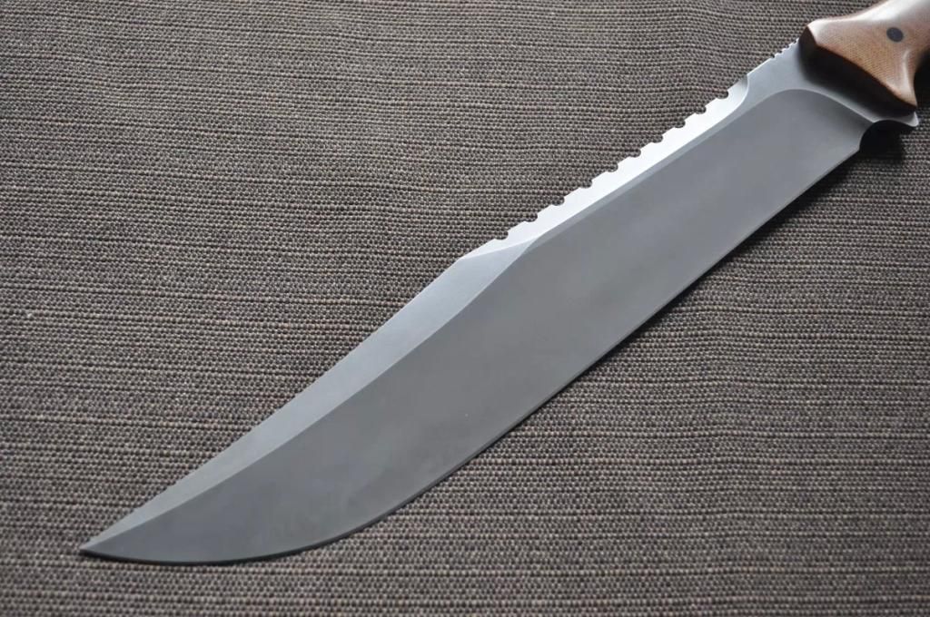

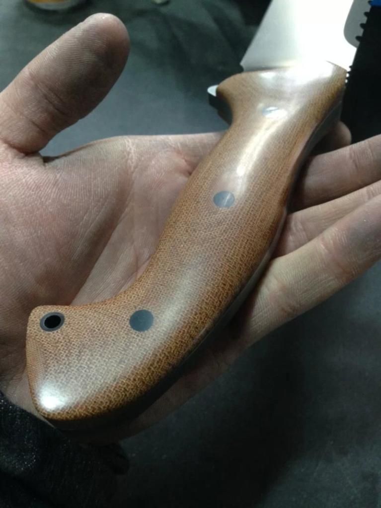

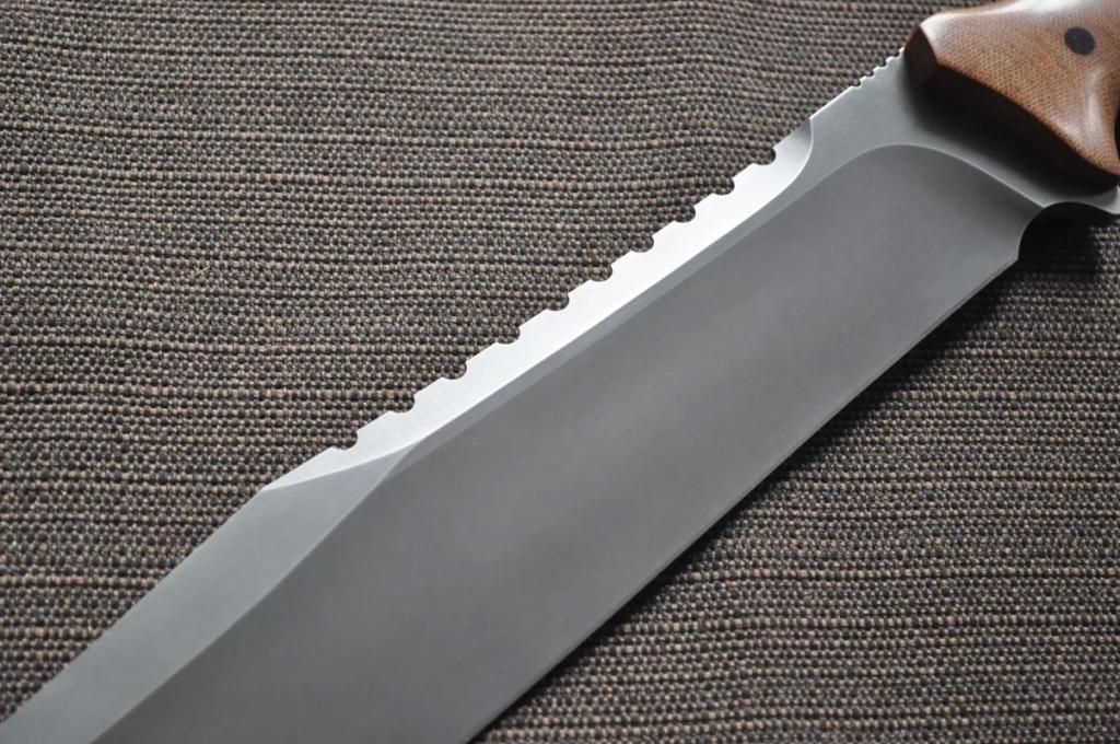

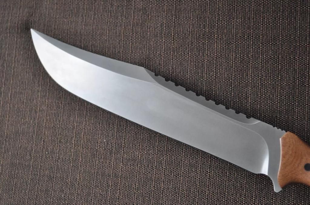

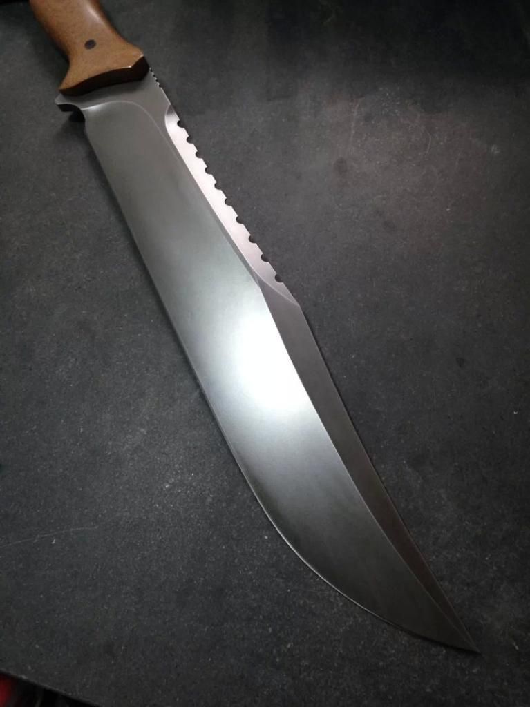

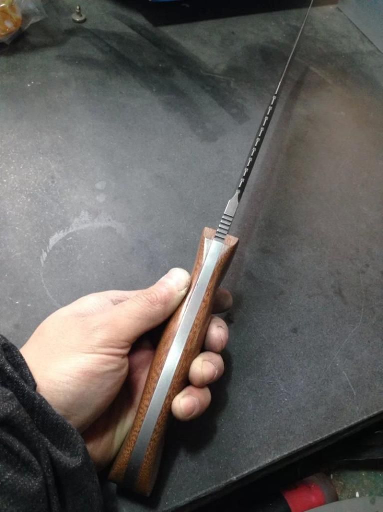

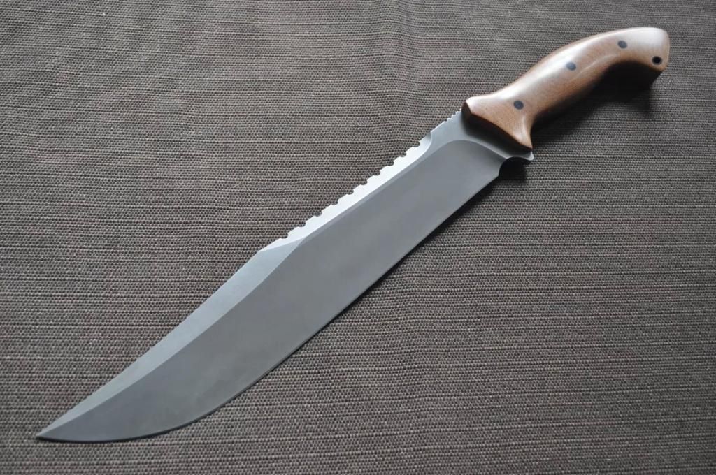

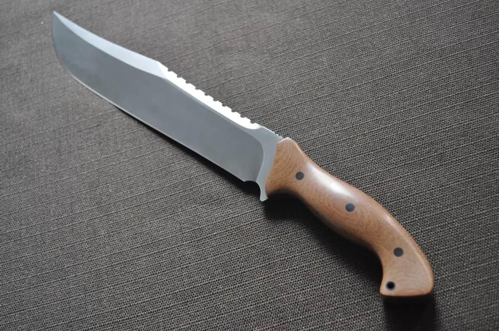

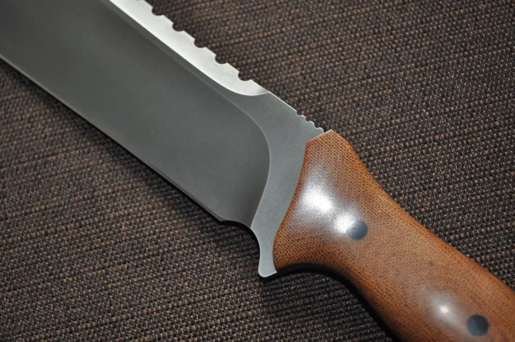

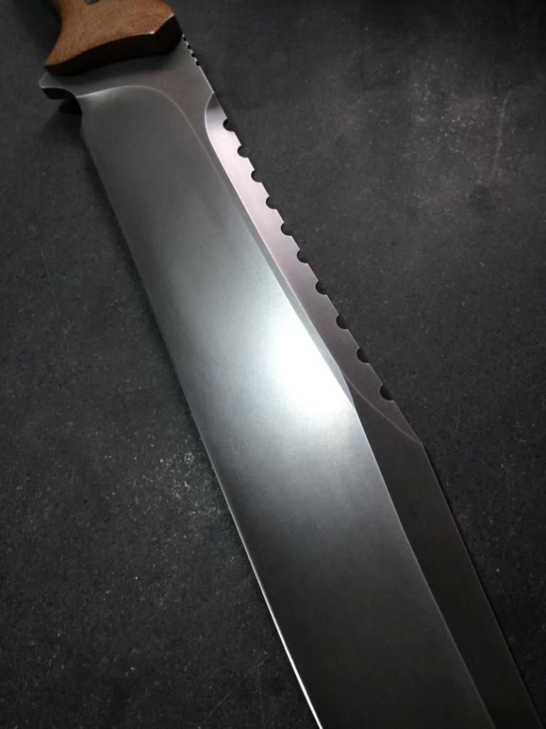

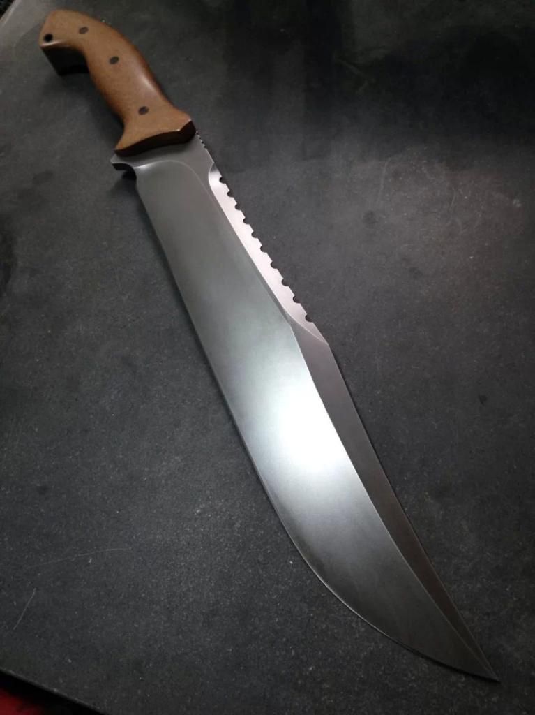

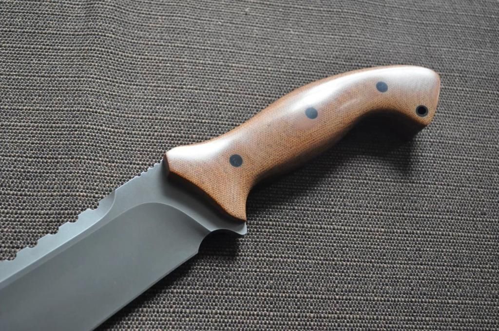

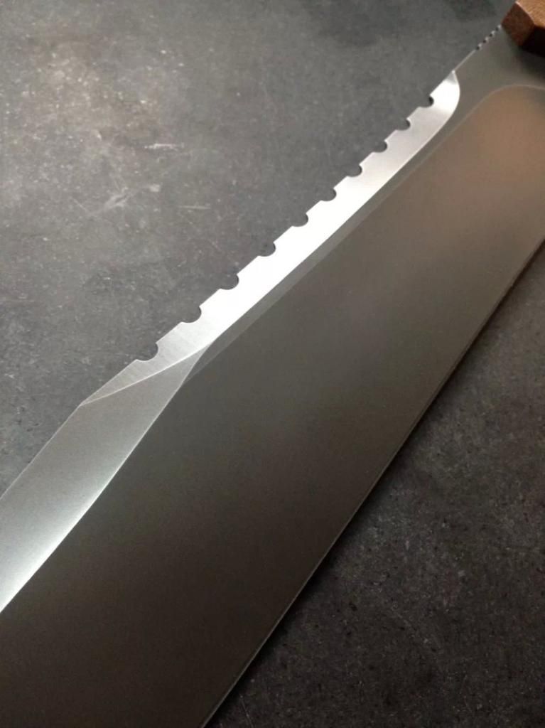

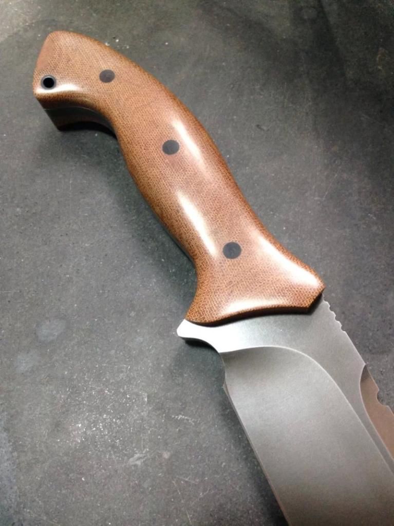

Hi everyone,here is my big knife project--Headhunter.
This is a really big knife,Total length is 17.2
inch!,blade is 11.2inch ,This maybe a chopper or a
fighter.I use AISI A2 tool steel Triple tempered to 58-59
HRC.I use canvas micarta and fiber pins as before,I hand
sand it to 7000grit then polish it,so its grap is really
smooth in handle.
Thanks for looking
J.bin
