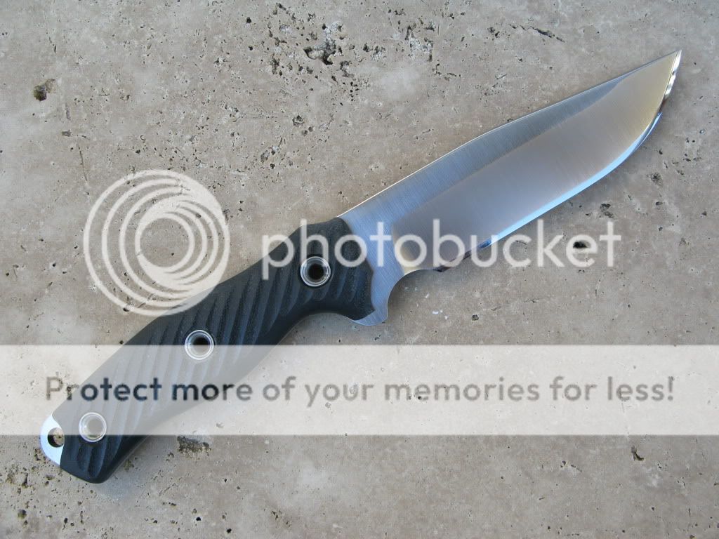

Some examples of polished convex edges; I think they look pretty good. :rolleyes:
(Police III only in this pic)

Twins?... I don't have a good pic of my modded RMD besides this one; it's sporting a decent convex edge as well. :thumbup:

You should be ashamed of that ugly edge and blade ;)
I wish I could take credit for the finish or the edge. Alas, I can do neither. Credit for those goes to Nathan (norcalblacktail) before he started making his own knives under the Kestrel Knives banner.
