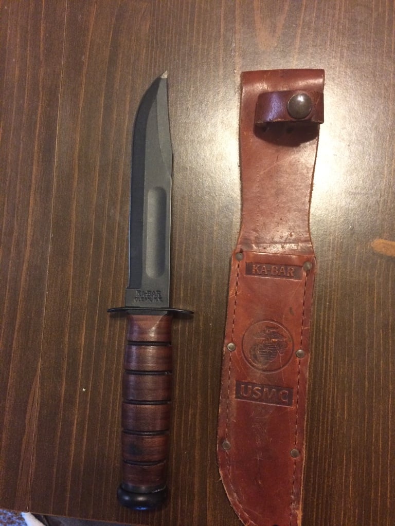

Has anyone ever takes a usmc kbar apart? I want to re-finish mine and want to take of the stacked leather and hopefully put it back on as my handle is in good shape.

This is mine for reference. Not sure the date, but it is stamped olean ny.
Got it for free when I found a bunch of junk outside a cabin in Tennessee a few years back
Thanks for all the advice!
That is a Kabar brand reproduction of the WW2 1219C2. Post 1978, pre-whenever you found it. Other than the tip coating being removed, it looks relatively unused. It will be pinned with a blind pin (only shows on 1 side) in the pommel though the tang.
To remove the handle, you will need to put it in a vice and use a drill with a bit slightly smaller than the pin to grab and spin the pin loose.
