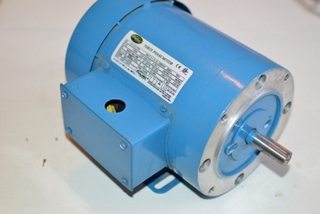

Craig, You are looking for the right motor but be sure to buy a motor that is listed as TEFC ( totally enclosed fan cooled) . It will have a shroud at one end with cooling slots in it. You need this because of dust in the shop that will ruin a normal motor. Here is a photo of a 2 hp tefc 208 volt 3 phase motor for illustration. Check out the shroud at the rear of the motor. This is what you want only in a 1 hp motor instead of 2 hp. 1 hp is plenty for a disc grinder. When you get your drive (VFD) most will have a space for a reverse switch which you need to install. A lot of guys use the Teco drives and are happy with them. I use KBAC drives which are dustproof and have a great reputation for reliability. They can be bought at a good price if you shop hard. Some of he knife makers here have found good places to buy drives for a good price and maybe they can help. If you want to make knives then a good disc grinder is a must in my opinion. Good luck with this. Larry P.S. This motor is a 56c mount as well as having a foot so it can mounted on it's foot or mounted directly to a grinder for direct drive. This is good because you probably will mount youir motor to a plate or some thick plywood but will need a "face mount" to install a work rest. LL
