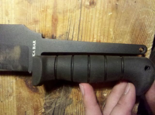

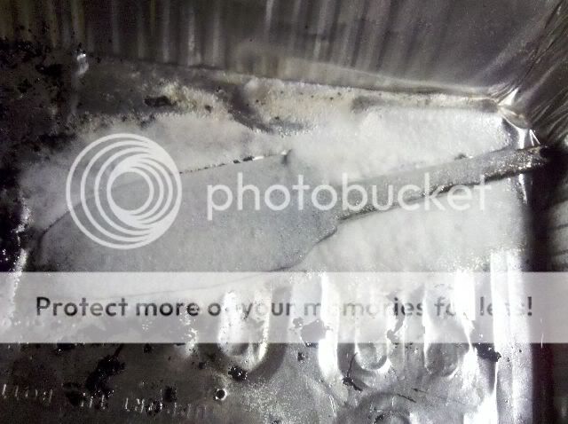

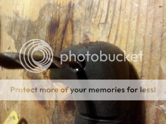

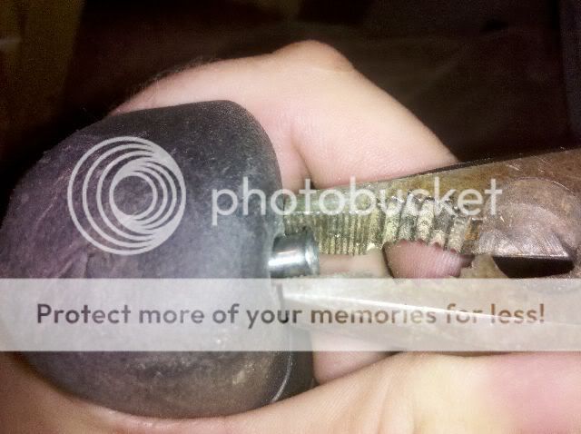

So I knew, because of the handle rattle, that at some point I was going to be forced to drill out the lanyard tube and pull the handle off my Warthog in order to epoxy it. The first-run versions of this latest revision apparently had an issue with this and mine was no different. But I was cool with that as I have some mods planned anyway, so tonight I had a few too many beers and decided to haul out the drill and paint stripper. Story of my life, really. Hell, I've got at least three kids because of that phrase.
Anyway, on to the pics.

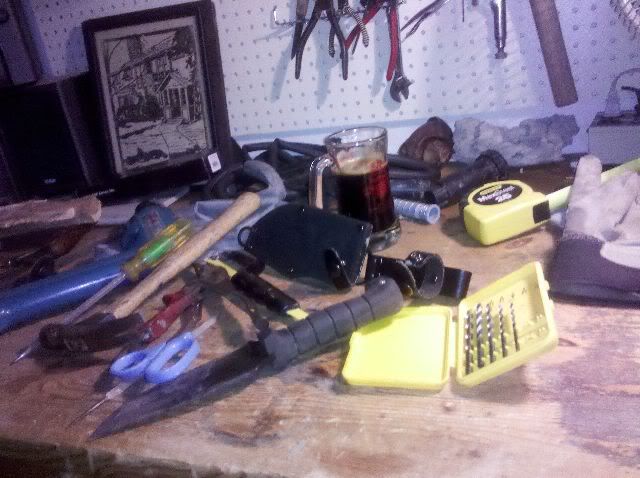

Here's my safety-first workbench, ready to get to bizness:

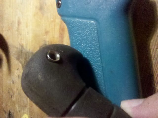

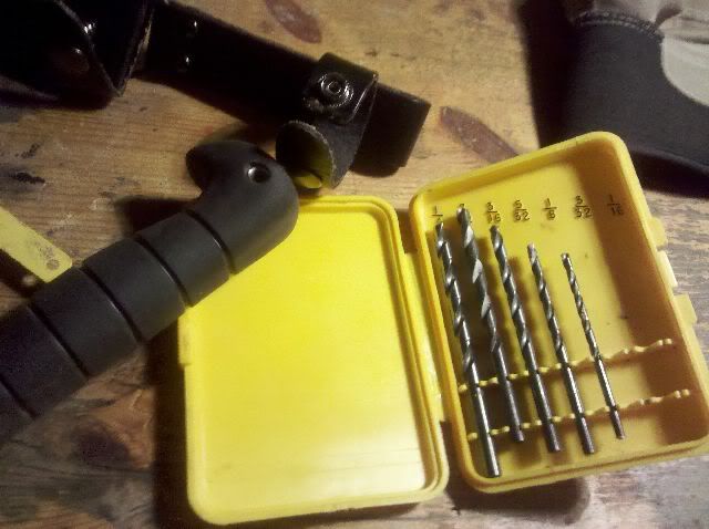

Ok, now to try to pick out which bit to use. Oh, wait, these are in inches... not gonna work on a Taiwanese blade :p

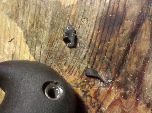

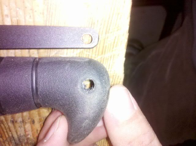

OMFG I AM DRILLING MY KNIFE AM I INSANE?
Progress

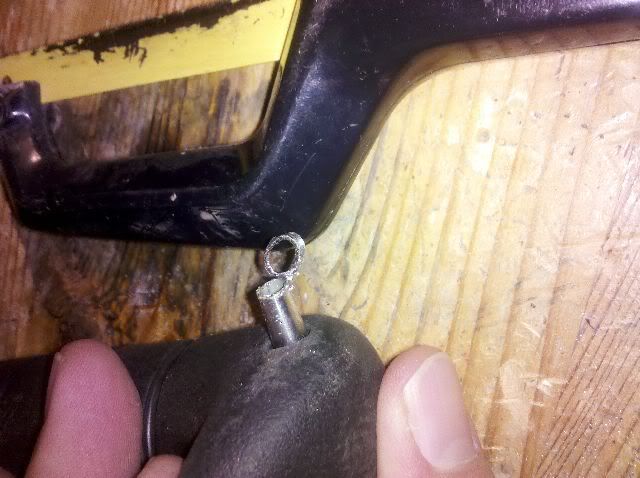

C'mon, get the <beep> out you <beep> son of a <beep>
Oh you made me get the saw out oh no you di'int
Kraton suffered a little from my crazy skills

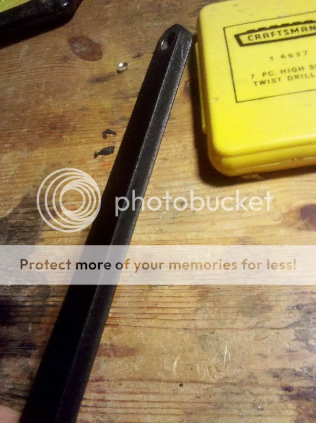

Ta Da: The Aristocrats!

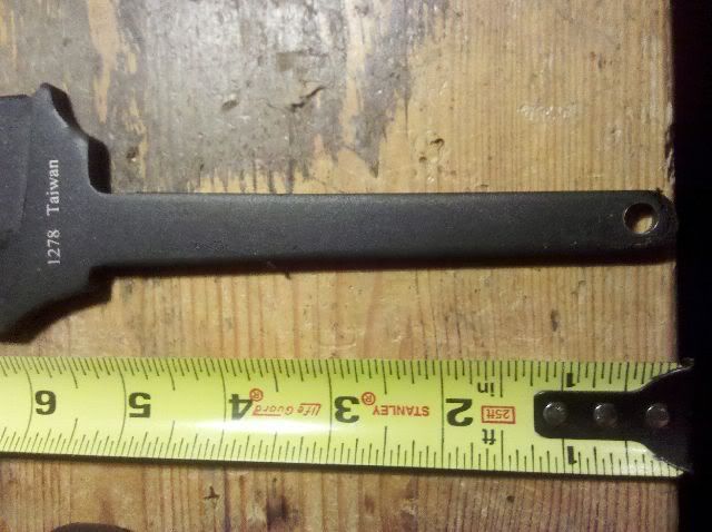

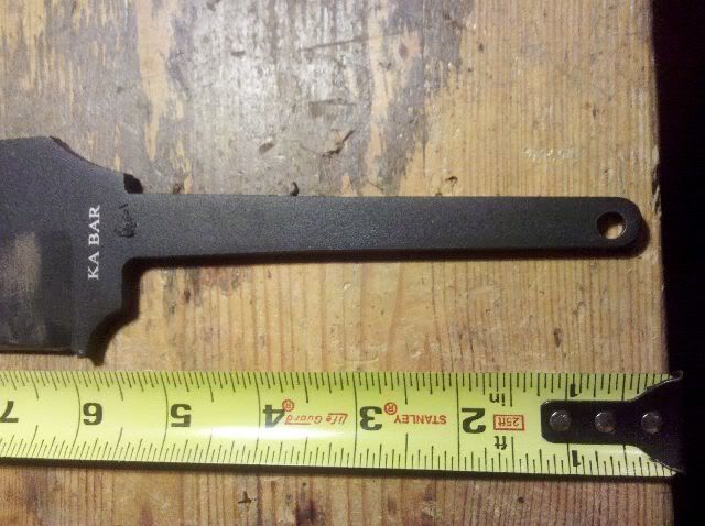

Here are front and other front shots of the Warthog tang and handle next to a not-scientifically placed tape measure
Closeups of the Warthog tang:

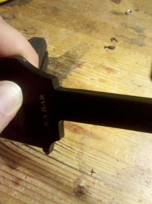

Inside the handle. I batoned directly against the back of the handle today really hard with a 3" branch and there looks to be no damage inside:

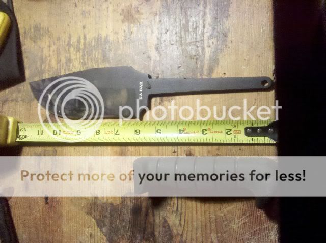

Simulating the blade placement against the handle, showing that there's appx 1/4" of handle covering the tang tip
More tang closeups, including a shot that most likely shows a slight swell from the press:
TO BE CONTINUED...
I for one thank you sir. I wish it was a full handle width full tang, but at least it is a full tang. I am looking forward to the end result as well. I also have one & use it hard. I try hard not to strike the handle though. I have numerous times on my Beckers, but they have a full width full tang, so the metal takes most of the impact-not the handle.

Good suggestions and thanks for the scrap offer Nick. Only problem? I have no idea what I'm doing. Hell, I had a really hard time just drilling out the lanyard tube, heh. In fact, I'm trying not to think about the fact that I have no idea how I'm going to replace that lanyard tube when the time comes to put my knife back together.
I'm pretty, but maybe not all that smart.
there's a faq on how to do this on the HI forum for rat tail khukris. it involves lots of epoxy, mess, and some time, then you have to sand and shape the handle
the simple thing to do right now would be to try some plastic shims, and see if that works out.
as for the rivet, so what the japanese sword thing and hammer a pin through as a starter. i'd use teflon or something, but perhaps you can find some nice tubing or metal or chopstick ;) glue it in if need be.
You can find a roll pin at your hardware store. Those would work nice to put it back together.
