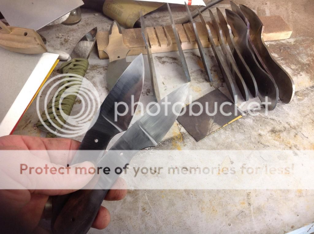

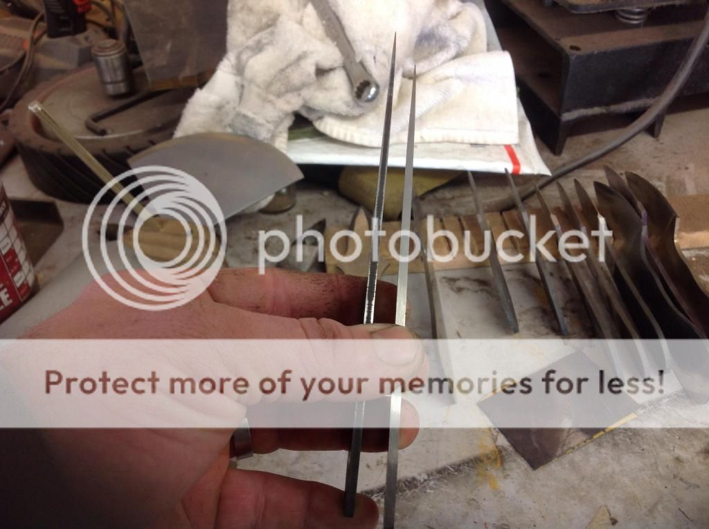

So after a few people suggested that I distal taper my gyuto it got me thinking and that can be dangerous. When should I distal taper my knives? Hunting, skinning......? I figure you would want a thick spine most the way down on say a survival knife so you would minimize the taper. It seems kind of inevitable on a drop point with a high or full flat grind. These are some pics of a small skinning or boning knife I'm working on. Too much taper? Help me understand the design of knives better and excuse the messy shop.
Looks very nice. It should be a real slicer which is good for the intended purpose.
Thanks Lo/Rez. I think it would be a benefit on a slicer or skinner but was wondering what other application it would benefit.
Full flat grind does not automatically mean you get a taper. Take a look at a Cold Steel Master Hunter. A taper does' have to be two straight line meeting at a point. It can have a little curve to it. As for kitchen knives, i think that an argument could be made that the taper allows you to maintain a constant bevel angle all the way out the blade which might be desirable. Also makes it way thin for delicate cuts with the point. :thumbup:
I agree that it doesn't automatically mean you get a taper but with a FFG and a drop point it seems inevitable. I'm not sure what you mean by having a little curve to it.
I think what you're getting at is the downward curve of the spine automatically means the spine thickness gets thinner as the spine curves down. This is true, but that's not a distal taper. If you took plain bar stock and ground it so that it tapered long-wise, and then cut a drop point out of it, that would be a distal tapered drop point.
To me (and I am a newbie) if those are pre HT they look a little thin. Hopefully someone more experienced will chime in as well on that.
They have already been heat treated.

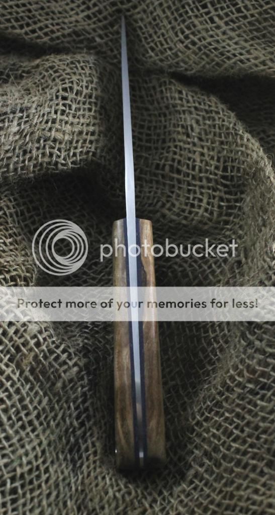

So would distal taper include taper on the tang? If not then it seems like the same end point (as a ffg and a drop point) but a different way to get there. Maybe it just isn't getting through my thick skull?
Distal taper refers to the taper of a blade from the ricasso to the tip. On a ffg with a drop point you will automatically get a distal taper.

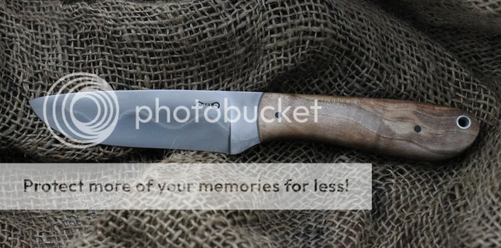

Here's an example of distal taper (ignore the tapered tang). I didn't try to do a distal taper but due to the blade shape and grind it appears.
Shane, that's what I am thinking. If you have a flat spine you would have to distal taper the stock before profiling. Good looking knife. What's the handle?
Yes exactly, or if you had a drop point with a saber grind you would also have to taper it first. That handle is wide curl maple. :thumbup:
Here is some of my experimental/test knives with distal taper (drastic taper = high cutting ability vs less distal for a stronger point)
Grind the distal taper after the profiling and before grinding the bevels for best results.
