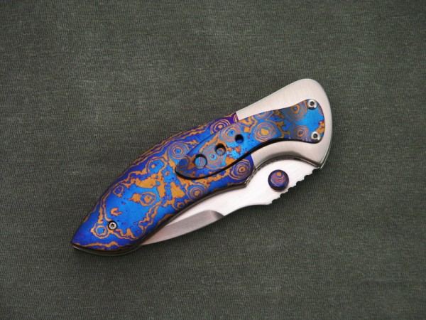

Is there a link or way to get in touch with the anodizer of this knife? I have a few yoyos I'd like done like this.
That's not from an anodizing process, that's a mokume gane multi layer of different Ti alloys in thin layers
You can somewhat replicate it by masking off areas and dong them at different voltages
do the higher voltages first
