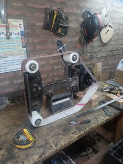

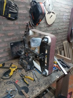

Hi friends! My name Is salvador. Im currently building a belt grinder for knife making and general purpose. I Will post some photos of the machine.
The project Is almost finished but i need to build a drive wheel.
My specs are
3 phase - 2hp - 1435 rpm motor - 50hz (4 poles i Guess)
Vfd 2hp single phase to three phase
3" belt width
I was thinking on a 6" wheel but this Is my first grinder and i would like some input from More experienced users.
Hello Salvador, I believe for grinding steel you'd want around 20 m/s belt speed, but having more would not hurt since you have a VFD and can slow things down.
Using this calculator: https://www.burrking.com/sfpm with 6" wheel and the 1435 RPM motor you'd have about half of that. With 10" wheel you'd have almost 20 m/s, but that may be a big wheel - it may be worth it going for a faster motor.
Other will correct me if I'm wrong I'm sure.

8"/20cm wheel should do. Not bigger as it's only 2HP motor. Not smaller than 6". For occasions where some speed is required, VFD can speed up the motor to 200% as it uses the same bearings as 2 pole motors.

Thanks pafka! I need to use this motor cause i runed out of budget. 😅

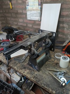

I designed the grinder thinking i would use a 4" wheel with a fastest motor. Lately i decided to use this old motor that was laying around im my shop. I recently put new bearings and grease on it.
The thing Is im seeing that i can Fit a 7" wheel Max 😢. If i go for a bigger wheel the extending arm touches the Main body.
Im interested in the method of speeding up the motor with the vfd. Motor runs at 50hz so for a 200% boost as you say it means i need to "overclock" the motor to 100hz? Is that right? Does that boost pose some danger for the motor?
Thanks for the help both of you
