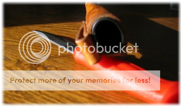

I used the plastic sheath, cut off the belt loop and formed a leather sheath around the original plastic sheath, creating a nice liner for the leather sheath, made a leather loop in place of the plastic one. Turned out so nice that I plan to do this to all of my Mora blades.
That doesn't sound like a bad idea, Iuke. How much leather did you use and what weight/thickness?
I used 6-7 oz leather because that's what I had on hand, but since you are wrapping the ridgid plastic sheath, you could get away with something much thinner, say 3-4 oz. Here is a quick shot, sorry for the quality.
