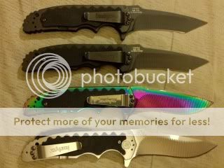

Heres my four of a kind. The Tanto actually has a hollow ground striated hawkbill with a flat ground n striated tip. I think it's the closest to a Rampage grind that Kershaw has produced so far. Now discontinued.
Let me know if you want some more specific angles.

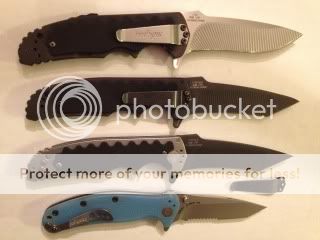

Here's a pic of my Tanto partially serrated Zing. You can see the Groove backspacer pins installed and you can see white between the blade and liner. It's Teflon. I checked when I put those ice blue kyrpto-glow in the dark scales on.
I think it's one of the later ones, it was purchased in bulk with no boxes.
So here's what I ended up with.
I tried the bronze phosphorus washers in the Zing. They were a little wide but fit okay. But the flipping action was impaired.
I didn't even try the Teflon washers in the Groove Tanto cause they were about half the size as the BP washers, didn't think they were substantial enough to hold the blade properly.
So I ended up using the silver frame with the Tanto blade. That will be my new main user. The best of the black parts as a safe queen. The recurve with the DLC frame is like leftover spare parts for now. There was hella lock tight in there that stained the DLC frame and made it difficult to didassemble.
I noticed that both DLC blades around the pivot were scrubbed almost down to the metal and the BP washers were polished. The silver recurve was less cared for.
