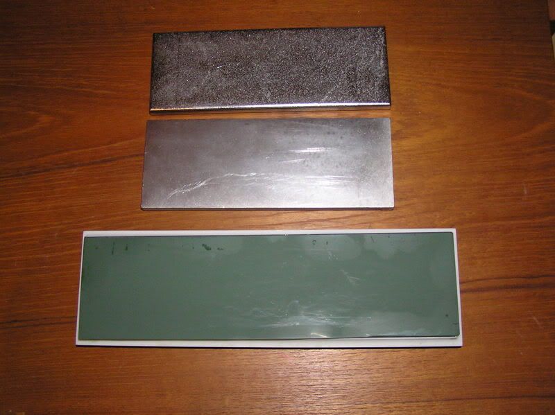

For a 4", it would be ok, but I like more room. I have the black, blue, red, and green in 10" dual sided stones black/blue and red/green, though, not 6 inch. The D8XX only comes in 8", I would have bought a 10" if they would have sold it.
Here's a picture so you can see the relative sizes. The top stone is the D8XX, the middle is the D8EE, the bottom is a 10" hone from Hand American. My 10" DMT's were in the garage, and I got too lazy to get them, but this is the same size. The HA setup is wonderful, corian base, magnetic, you can attach leather hones (that have a magnetic backing), but this is a glass plate with some Lee Valley sub-micron paper on it.
http://i137.photobucket.com/albums/q203/sodak_photos/dmt1.jpg
