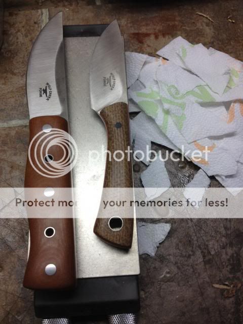

I own the 8" plates from XC-EEf and love them. You can get a surprisingly sharp edge off the coarse stone(sharp enough to clean cut paper and shave arm hair) go up in grits and it just gets better..I recommend their products. I just sharpened two of my personal knives on them the other day..One in cpm3v and one in AEB-L..Both would easily slice free hanging paper towels and tree top/whittle hair off the EEf and strop..
