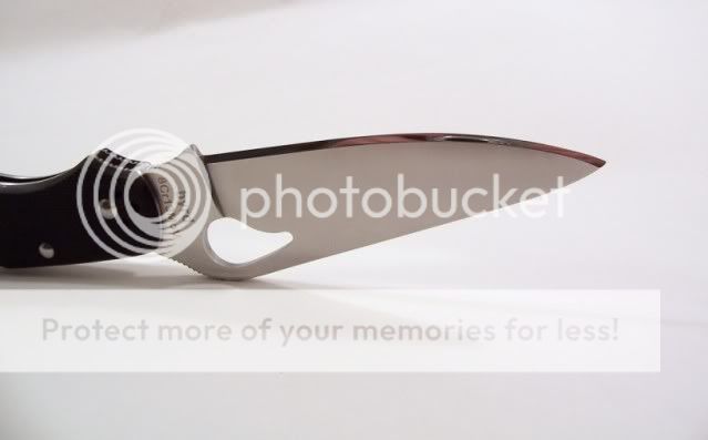

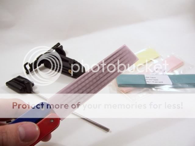

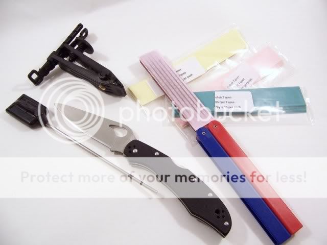

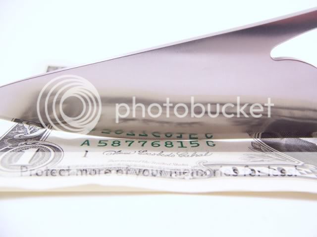

I toyed with the idea of getting a EdgePro a while ago after seeing all those awesome mirror edges that guys were getting with it. I'm a pretty cheap guy and it would cut into my knife and flashlight money so I just couldn't bring myself to spend the dough to get one. I went the DMT continuous stone/paste route instead and got really good results with them. But I still wanted to try a clamping based system because I was having trouble hitting the edges at the base of some of my Spyderco knives. I liked my DMT stones so much that I decided to give the MangaGuide a try. I got the C through EEF diafolds with the system and had a go with it. I got good results with it. I was able to get hair splitting edges with it and was able to reprofile some knifes. But my mind kept wandering to those EdgePro mirror edges while I was using it. Then one day I was watching a Youtube video on the EdgePro polishing tapes and something occurred to me. Could I just use the tapes with my MagnaGuide. I ordered the 2000, 3000, and 6000 tapes and decided to give them a try. What could be the harm in trying right. While they came today and I practiced on my new Cara Cara 2, a good cheap knife with an easy steel to give them a try. I was able to reprofile the factory belt sander marks away with the coarse diafold then I worked my way through to the EEF. Then gave the EP tapes a try. I just peeled them off and stuck them right to the Diafold and work my way through the three. Here is my results.

I tried the clamp with the bench stones and I just couldn't get the the hang of it. It felt just odd to me.
The 2k tape worked to take the EEF scratches away but it took some time.

I cut them to size and stick them onto stones or blanks using ordinary white paper glue sticks. The tapes peel right off the stones when you're done and everything cleans up easily with plain water. You don't even need any soap!

Great ideas! I imagine if you could mount the tapes to something smoother than the diafold stones it would increase effectiveness. How hard would it be to have a piece of glass cut to the same dimensions as the DMT Aligner Stone Holder? Then you could mount the tape to the glass for some real mirrored edges!
Just a wee bit harder than ordering a pizza... Certainly no more than that. Just use tempered glass for safety. I glue the film right onto extra fine stones. They feel like glass anyway. I also glue them onto aluminum tape blanks for my EdgePro. Frankly, I don't think using glass will give me any real increase in edge polishing. I get that from a horsehide strop.
