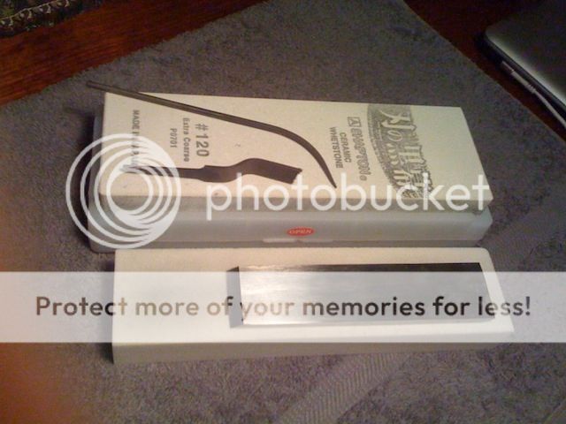

The photo with the white stones shows one of the thick plane blades I was making from old Nicholson files I ground the teeth off of . . .
(these are the good old stuff before they went to Mexico (I have proof the Mexico made are not as hard if you want to see it)).
The Shaptons sharpen it fine. The low grade 80 grit stone stopped cutting in no time and would need to be freshened on a diamond plate so I ordered the Shapton 120 . . . it cut, and cut and cut and there was no let up.
Of course these are not super steels but harder than about any knife except the ZDP-189 I mentioned and I found more important than hardness was when one got into a wide bevel. That was power grinder time . . . but the little tiny bevels we are talking about on a curved knife where there is just lots of force per square inch because the area is so small I'm just not seeing a NEED for diamond if one has a coarse stone like the 120 Shapton or there a bouts.
The chisel is Hitachi blue paper steel; not super steel but no slouch in the hardness department. As you can see mirror polished and I steepened the bevel from about 25 to about 30° to eliminate chipping while cutting super hard woods. These bevels are seriously wide not just cutting on a curved, bellied, knife blade and a little thin bevel.
Too hard to sharpen on a Shapton . . .
