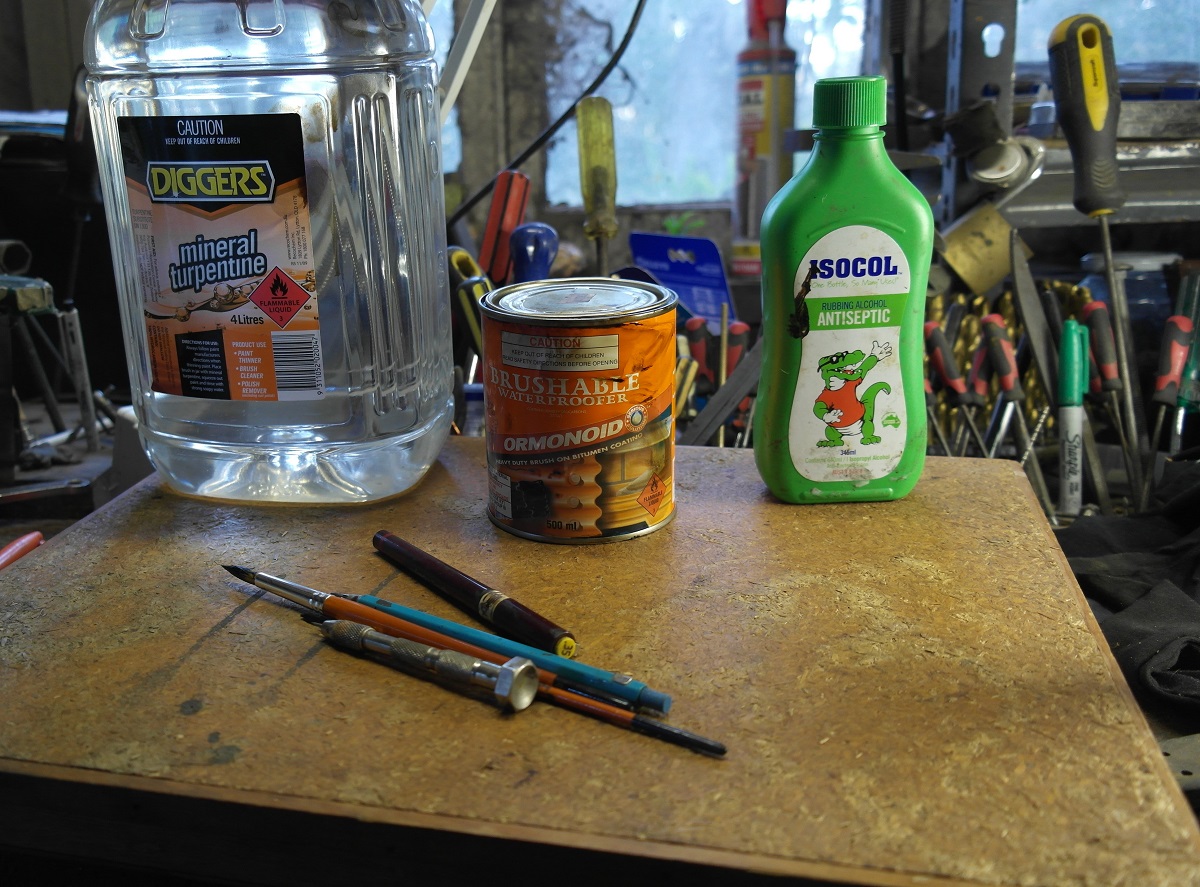

What you need.
-A technical pen or nibs.
-A needle
-Paint brushes
-Pencil
-Mineral Turp
-Brusable bitumen paint
-Alcohol or any other cleaner/degreaser.

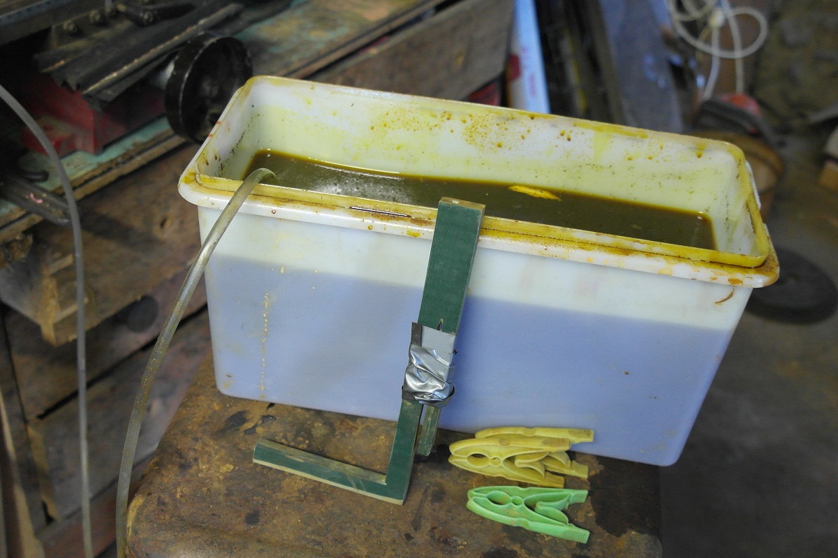

You also need a plastic container for the ferric chloride (that's the acid).
I use one in which the blade will be held horizontally. It gives a better etch than a vertical container, as the dissolved particles of steel may leave marks on the blade.

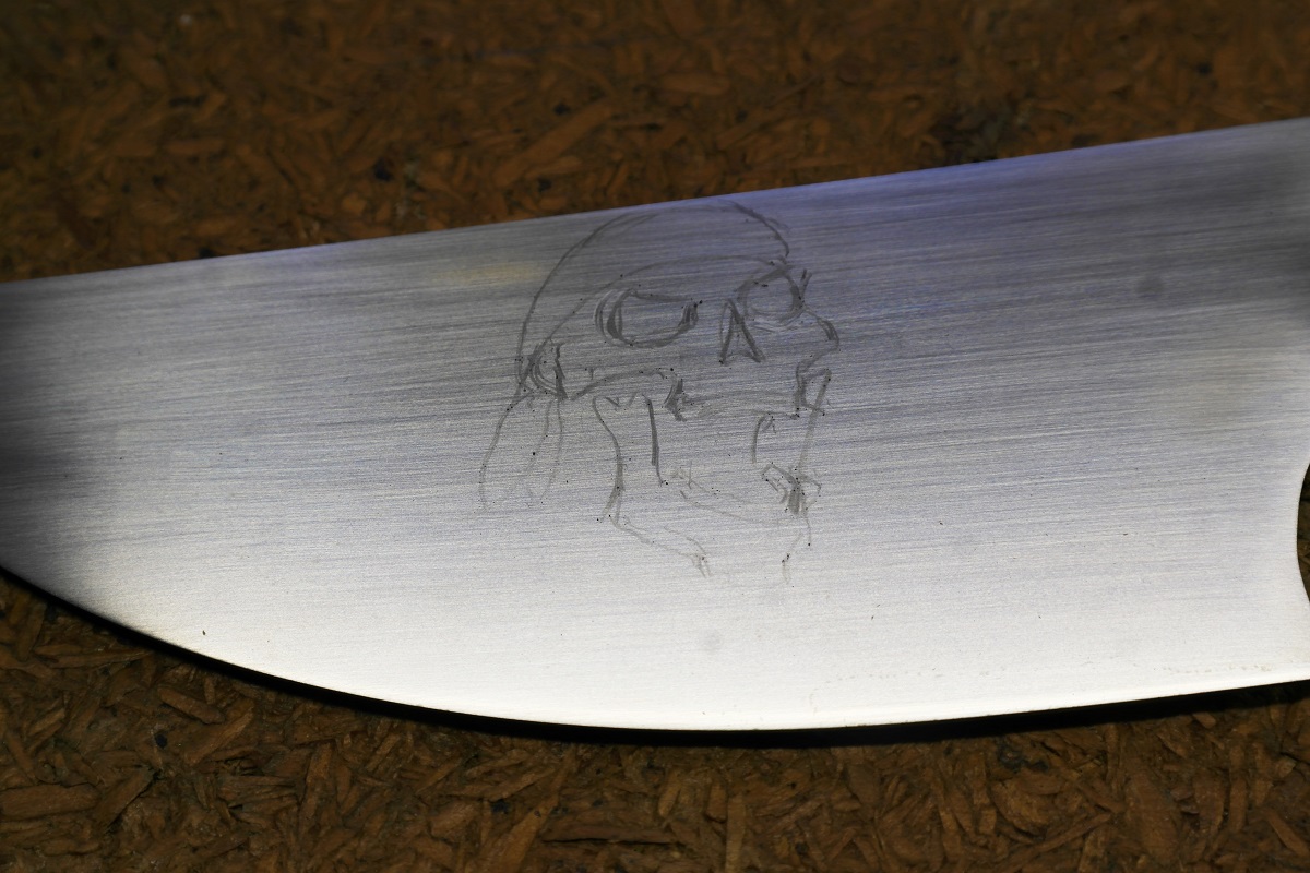

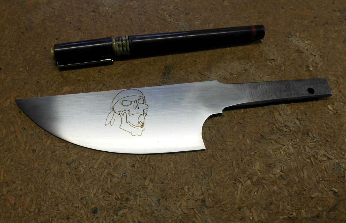

There are ways to transfer a design onto a blade, but I'm doing this one free hand, using a pencil to draw the first part of the design.
The blade is RWL34, polished to 1200 and hasn't been heat treated.

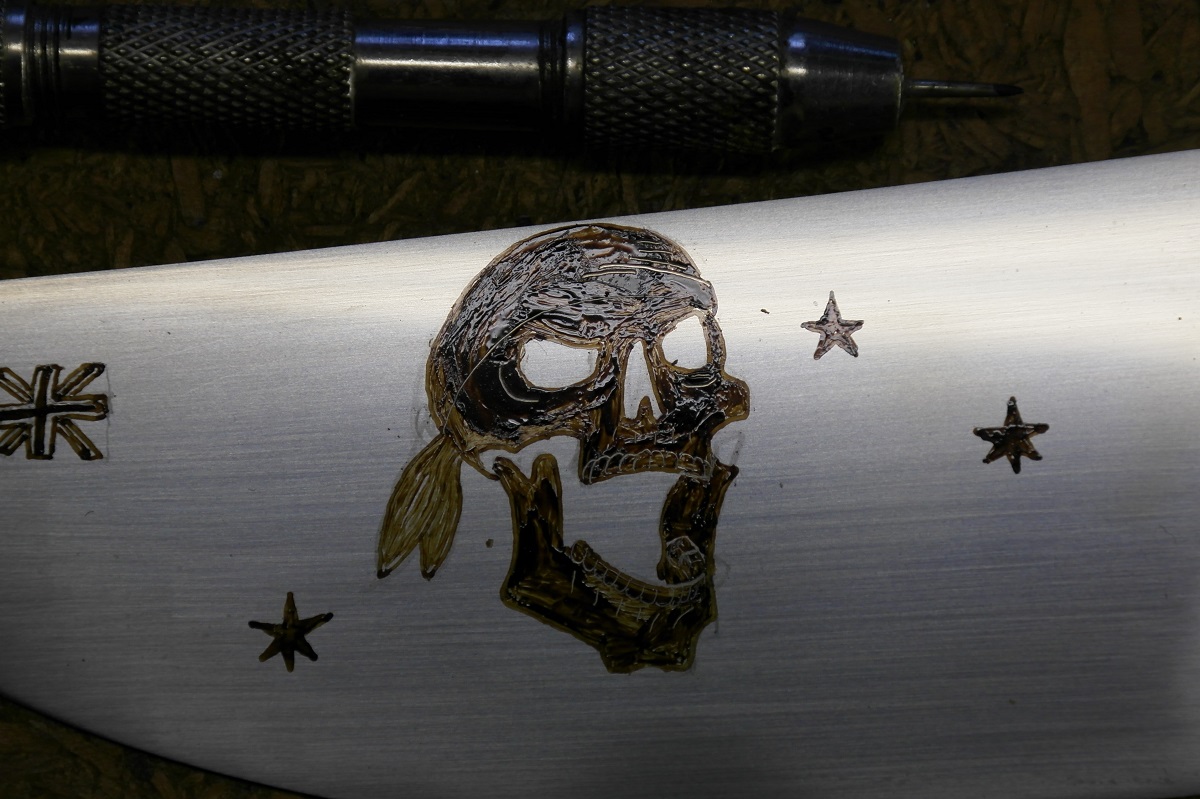

Using the technical pen (Rotring filled with thinned down bitumen paint), I go over the pencil lines.

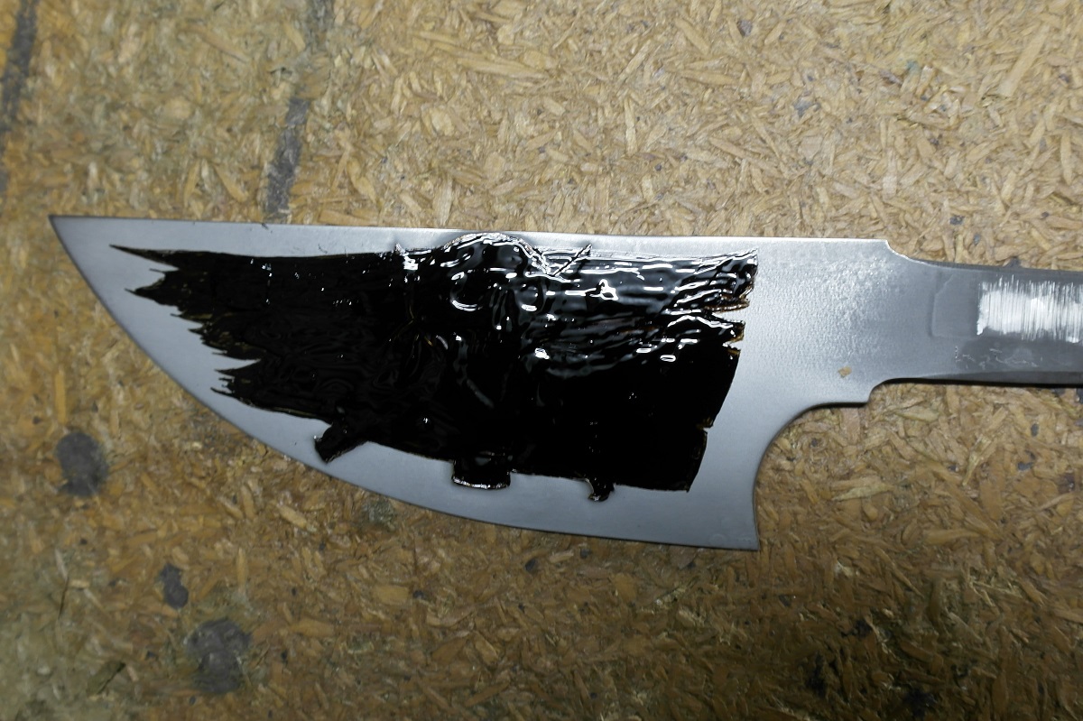

Then, using a paint brush, I fill up all the parts that I want to protect from the ferric chloride and add a few more details.
2 coats is safer than one.
Once the paint has dried, I use a needle to scratch the details of the skull, like the bandana and the teeth.

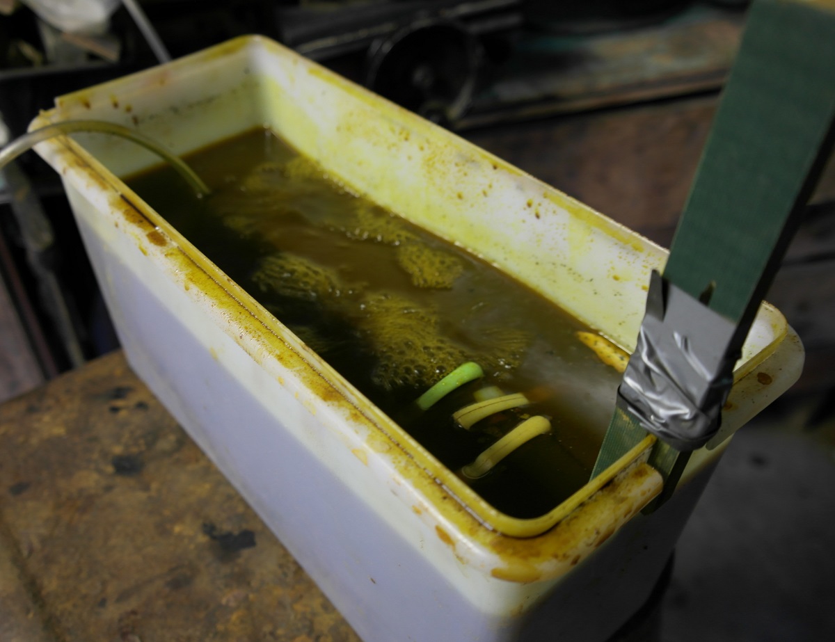

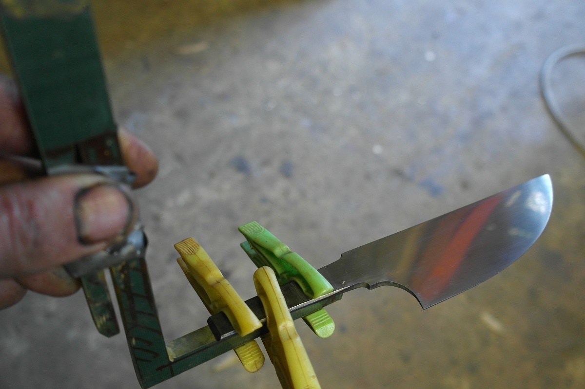

The blade is ready for its first etch. I use a clamp made of g10 and plastic pegs to keep it in place. Note that the design has to be facing down.
The blade is now being etched. To speed up the process, and remove particles without having to touch the design, I have a small fish tank pump that blows air into the tank.
Every etch will take 25 minutes.

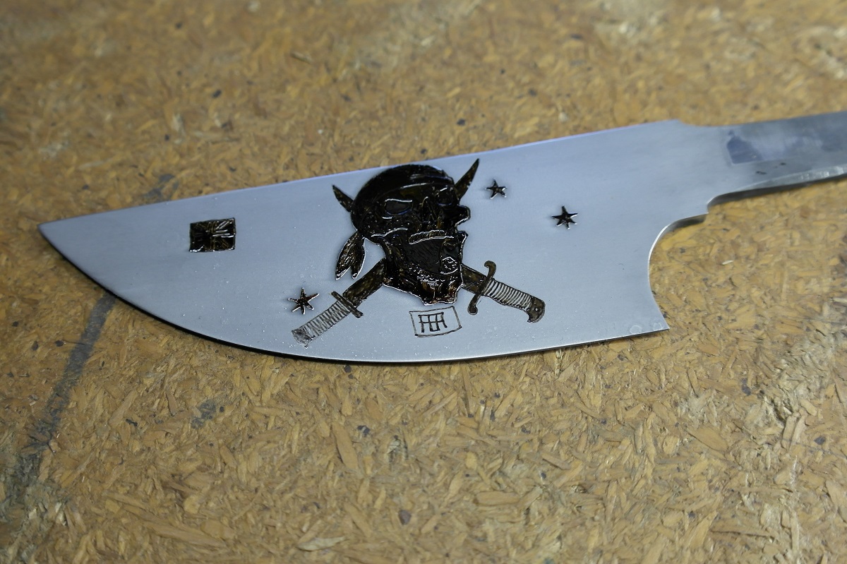

The blade has been buffed to make sure it's still smooth, and then cleaned.
Make sure YOU DO NOT PUT YOUR FINGERS ON THE BLADE AT ANY TIME.
Oil from the skin may affect the result.

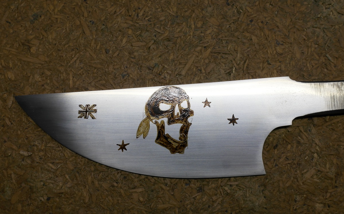

I paint over the first parts of the design, as I don't want them to be etched any further, and I add 2 swords behind the skull and my maker's mark.

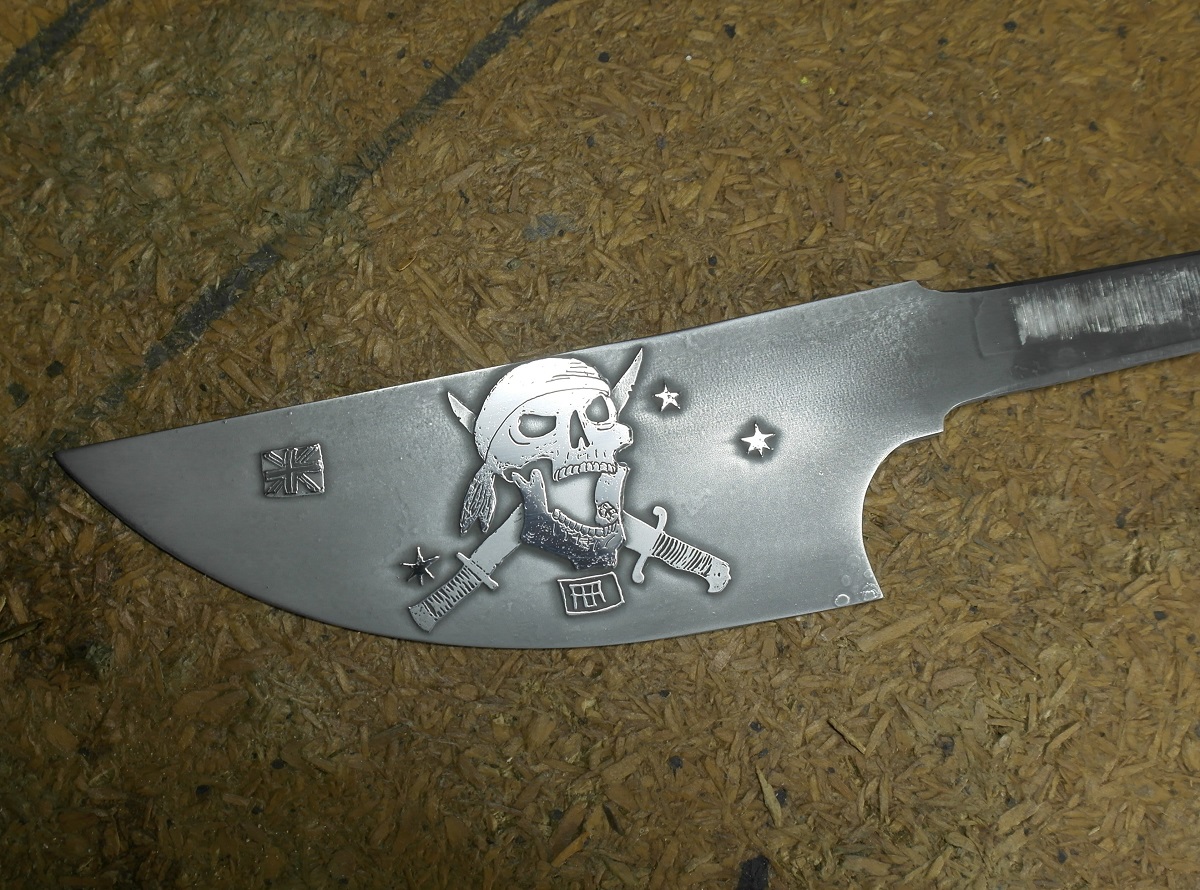

After following the same steps as for the first etch, this is what it looks like after the second etch.

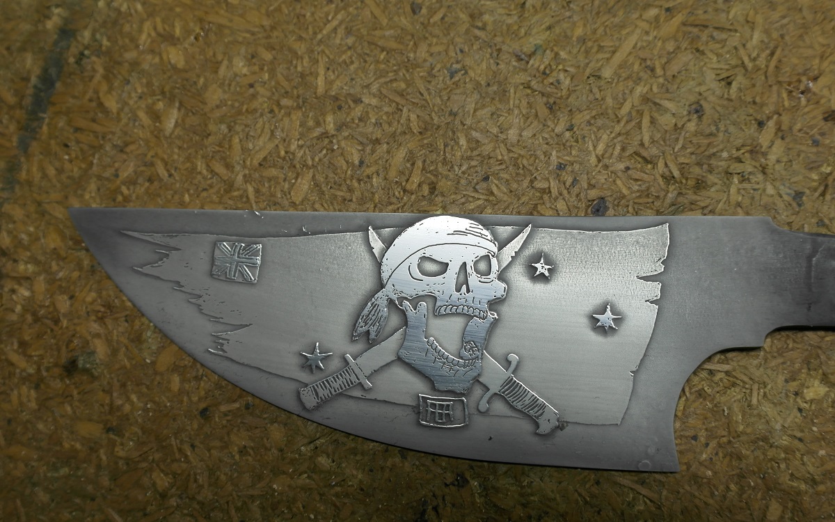

Here comes the third and last step. This time I add a flag behind everything I've done so far, and it goes for a bath one more time.
After the third etch, this is what it looks like.
Since the blade is made of stainless steel, the etching is done before the heat treatment. After the blade is heat treated, it is impossible to guarantee a good result, as the blade may not etch evenly.
With a carbon steel blade, etching should be done after, when the blade is finished.
After heat treatment, the blade and its handle are put together and that's done.
