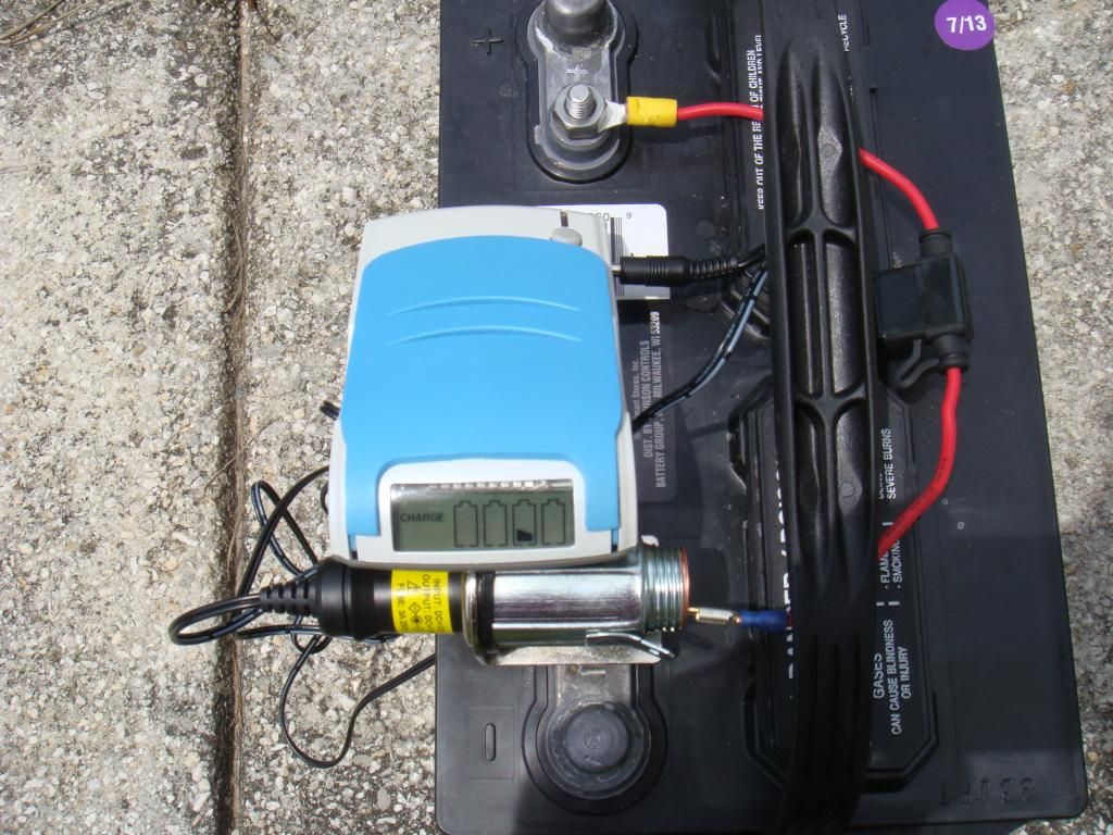

I'm trying to standardize my hurricane electronics to Sanyo AA Eneloops... I chose the Fujifilm SCH808F controller charger.. it inputs 12v dc, 120 v AC and 5 v USB... shown with a deep cycle trolling motor battery I use for my digital portable TV and 12v fans... the battery has a 12v female receptacle permanently attached to the negative terminal.. the charger will handle 1-4 cells... works with my Goal Zero 7w panel
Cereal killer... it's a 94 amp hour battery, and have not tried it that much with the Eneloops... I put it together this year before the start of the tropical season, and luckily didn't need it... the Goal Zero 7w panel took a little over 3 hours to charge my first pack of 4 Eneloops (they come partially charged) using the 12v plug using the Fujicell charger... I later obtained a Guide 10 pack and it took about the same time with the USB plug, with a slightly higher charging current... the battery is primarily for my small digital portable TV... after the 8 day power outage in the 2004 season, entertainment moved up a notch on the to-get list
