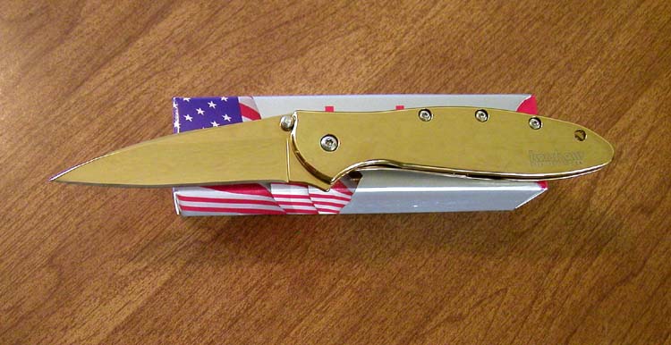

You mean like this?:
The steel itself isn't gold colored, it's just coated to look like gold.
gold coated, cold coloured natually is probably impossible? besides it has "gold in it"

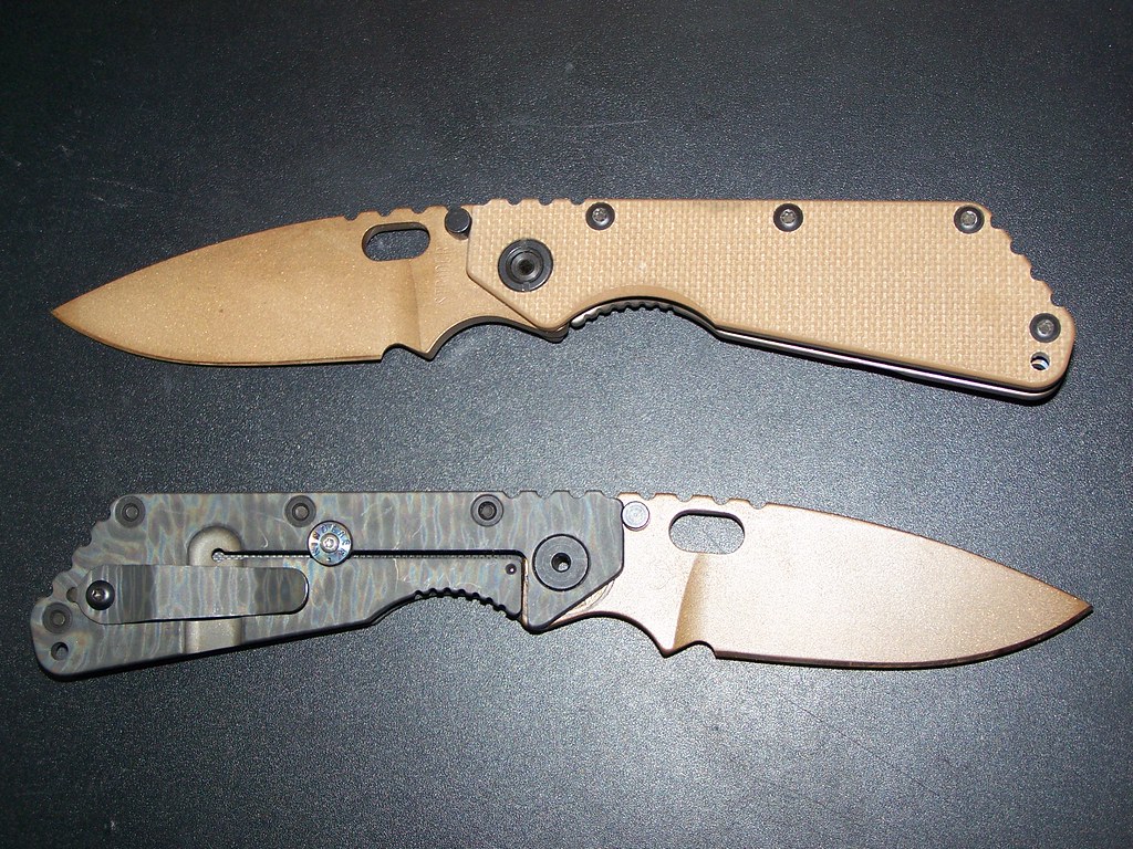

Closest thing you'll probably find is the Strider SMF CuBe with a Copper Beryllium blade. I believe it was designed for the EOD guys.

There are some old diving knives that were made from copper beryllium that has a brass/gold color. From what I understand it was nasty stuff, definately not a good material for a knife that might come in contact with food. I have no idea how good the blades were, but they were supposed to be nonmagnetic like titanium. current good blade material that is brass/gold colored would be really cool. maybe one day.

I think the only real option is Copper Beryllium alloy 25. Its the hardest of all the copper alloys, but from what Ive been able to find it can only get to 45 Rockwell hardness. Its extremely poisonous as vapor or while ground up as dust. Probably not worth playing with unless you really know what your doing.
