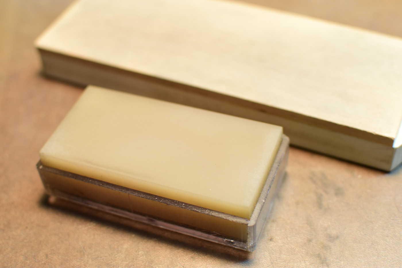

I have a Kizer Kyre 3 1/2" blade with VG10 steel. It had a decent edge but I wanted to improve it. I have had this stone in a drawer along with my strops etc. and decided to give it a go. After about 20 minutes it has one of the best edges on any knife I have. Hairs fly off my arm and with its own weight push cuts through phone book paper without any tearing. The stone is only 4" L x 2" W x 1". The color could be opaque. Very impressed. Not sure of the grit/micron as I don't think these stones have this type of rating. Lightly stropped on 0.50 and then 0.25 diamond spray on a balsa wood strops. Will add this to all my hand sharpening. Very impressed.

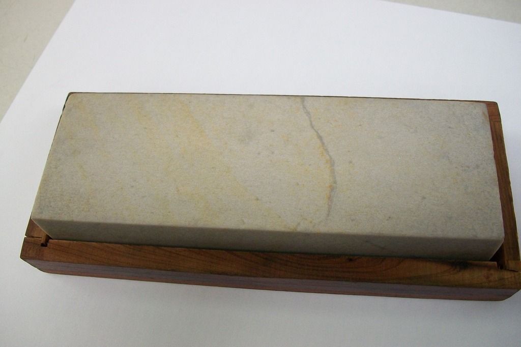

Here's mine, had this one for over 20 years and is the stone I used to make my first "hair whittling" edge. Doesn't get used too often anymore but I still pull it out from time to time on my woodworking tools of carbon steel. Haven't used it on stainless in long time.

The small one in your pic is a hard translucent, which provides the finest finish of the Arkansas stones. I don't have one of those.

rpt, your stone is a translucent grade Arkansas. Around a 1000-1100 grit. I have read the the Black grade Arkansas stones are finer than a Translucent. I'm not a Geologist or work in a quarry. The Arkansas stones are graded by Specific Gravity. (weight by volume). I have all the grades of Arkansas stones, Washita up through translucent & black. I use the black mostly with my straight razor. It produces a good edge on it. They polish more than remove metal. Except the washita, a 4-500 grit stone. Being more coarse it removes metal and I sometimes use it to sharpen some simple stainless steels. i.e. 420hc, 425M. Members have posted these stones can refine a edge on many steels well.

Thanks for all the replies. I also have a soft Arkansas and need to play with both since doing a bit more freehand sharpening. Used soapy water with the hard stone. Still can't get over the edged it provided.
