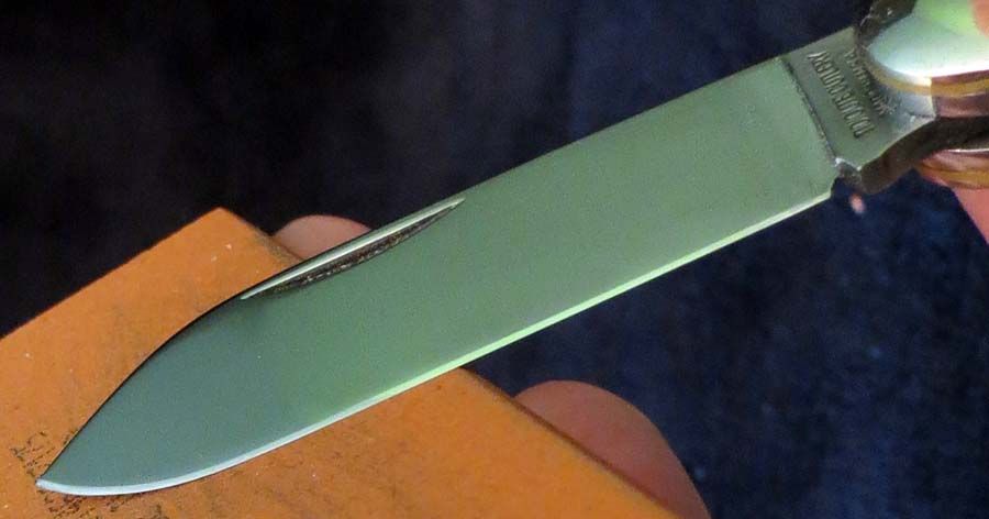

I've found that since I started sharpening a different way that I can get a very fine point at the tip of the knife, my method goes basically the opposite of normal, in that I hold the knife in one hand, the stone in the other and start with the tip of the blade and bring the blade backwards against the stone, more like a stropping motion you'd do on a leather strop. This, for me, allows better control of the angle and provides a consistent edge bevel, also allows to get better sharpening near the start of the blade as well. So instead of trying to slice off a piece of the sharpening stone, I'm dragging the blade backwards, also I'll be pressing down on the blade with my index finger so that the pressure is not relayed to the blades pivot, helping to prevent any unwanted blade play.
Now it's just removing metal, backwards or forwards, but since I've started doing this I find it easy to maintain the angle a lot better, instead of pushing the edge into the grit of the stone, there's less resistance and my hand stays a bit steadier.
Depending on the knife's condition, if I need to set the initial bevel, I'll start out with the 120 grit and move up to the 8k and finally a leather strop.

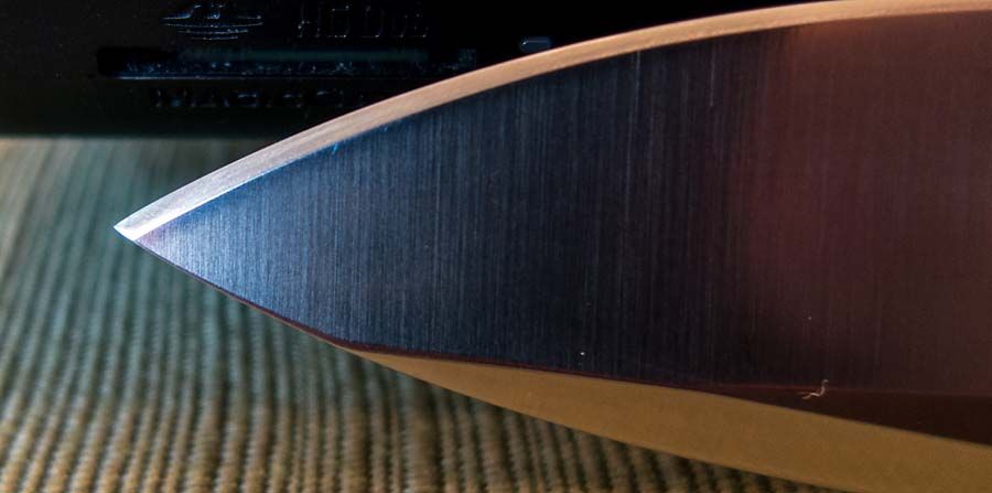

added this shot of a recent sharpening of another blade, slightly thicker grind so the bevel is a little wider, this one is showing the tip section;
G2
Edited to say David and I typed about the same time, sand paper works great too and I've used that more for getting the convex type edges.
Also I'm not one for really wide bevels, as you can see on that Chambriard blade above it's not too wide but then the knife is ground down fairly thin, I try to stay with the initial bevel angle that came with the knife unless it's too obtuse, then I'll reprofile and sometimes even add an additional bevel up above the actual edge bevel to help knock down the shoulders and allow the blade to cut through material easier.
