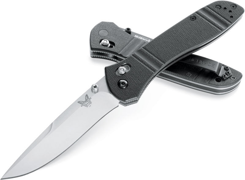

An example would be the 710. This is the model that the AXIS lock first came out on. The liners on the 710 do not have round cut-outs for the AXIS bar to slide through so disassembly of the knife requires the actual lock bar be taken apart. This is not a huge deal as most don't fully disassemble their knives but the newer models all (?) have a cutout so that the lock bar can slide in and out. The big difference is that you have to pull the lock bar all the way back until the travel stops for the blade to clear it and unlock.
On most of the newer models I have handled there is more room for the lock bar to travel. Some models like the 950 and 14205 have a ton of room to pull the lock bar back once it clears the blade. Other models are not quite as extreme as these but still have more 'travel' than the 710.
I find this additional room to feel better although I'm not sure I can put it into words why. On the 710, you pull it back and it stops moving and feels tight and like the spring pressure is higher. But on the 14205 you pull it back and it feels light and you can pull it back a bit and not worry about having to pull it all the way back.
Anyone else notice this? Do you find that the locks with more 'travel' feel better when using them? Any other thoughts on this? Below are some pictures. Look at the space behind the AXIS lock bar and the amount of room the bar has to travel.
What do you say? Am I crazy?
710:
