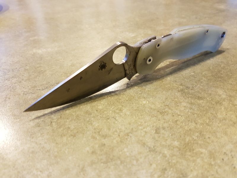

i just received my pm2 with 52100 and forced a patina not sure how I like it. Do you guys do that to the steels that will take it or let it happen on its own?

The more I look at it I like it. I really didn't know what to expect. I cut a orange in half and squeezed the juice in a container and soaked it for about a hour then touched it up on fine and uf on sharpmaker and stropped it a bit.

I think we need pictures if the sun comes out I will try to shoot side by side.

Went outside for some better lighting. I also noticed the steel has a kind of burning stink to it once it dried out. Now it smells like a gun lol
