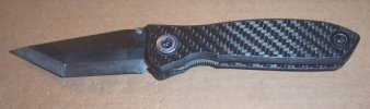

I have a Beretta Avenger, this knife has a laminated CF/VG-10 blade, the single bevel grind on the Tanto blade is razor sharp but because the angle is so acute, the VG-10 is paper thin, scary sharp(it fillets hair)the problem is that it is so brittle it get little chips in it.
I have't tried to sharpen it on my EdgePro, hopefully that will solve my problem.
