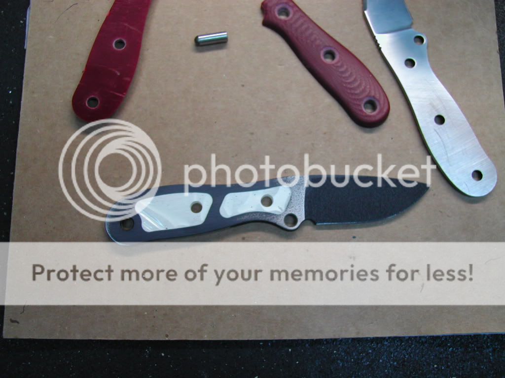

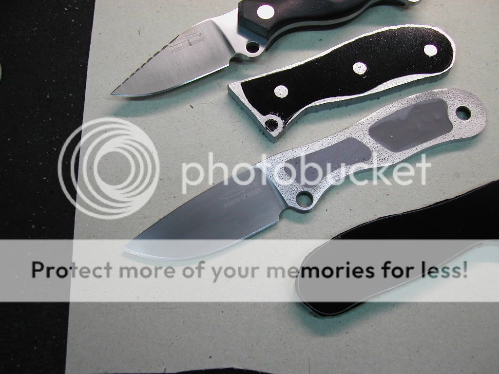

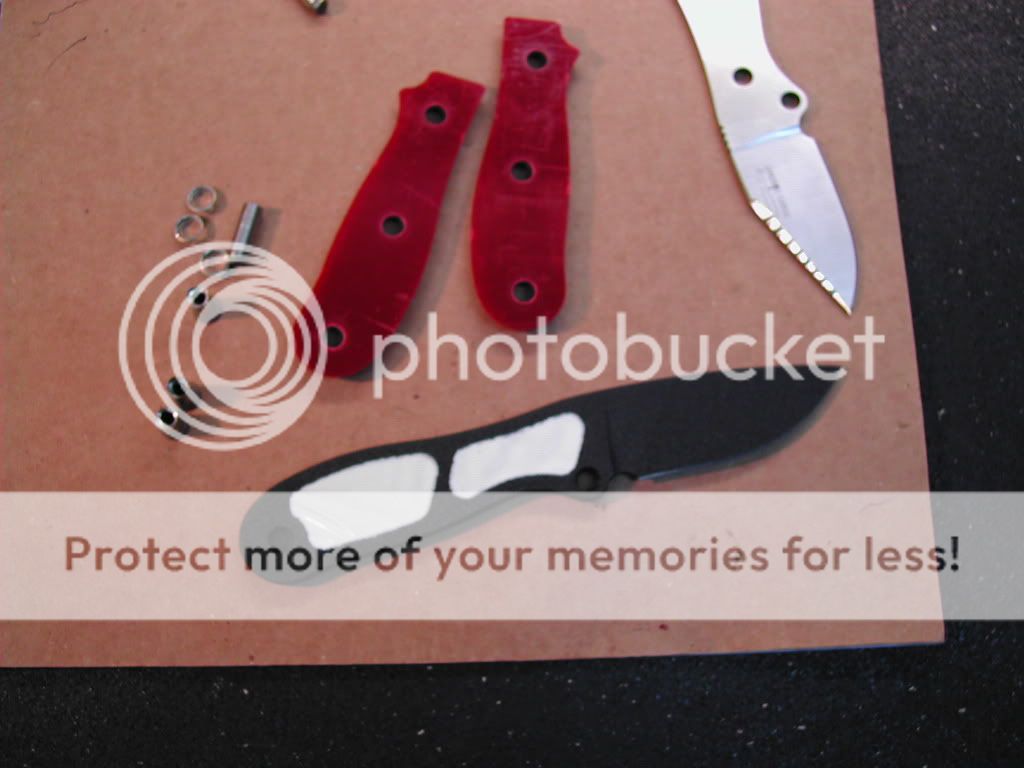

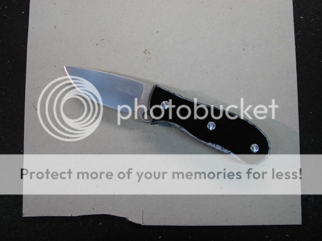

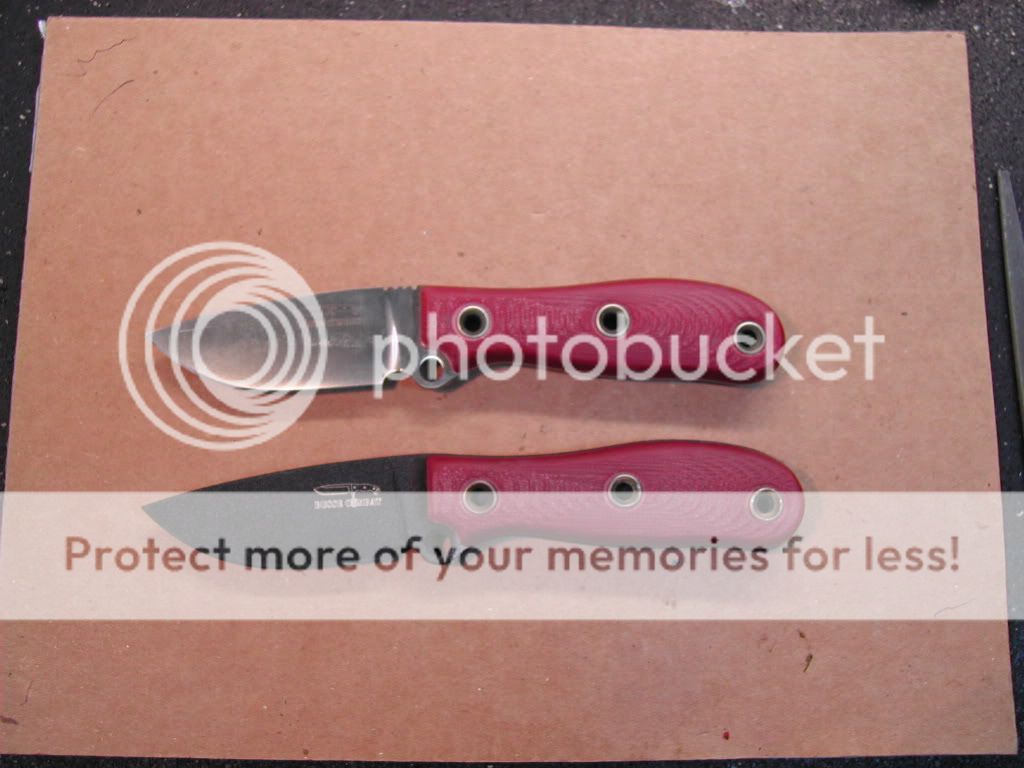

Here are a few pictures of a couple Skeleton GWs that I did. I filled in the cutouts with JB weld and drilled the fastener holes. Then made new handles for one and reused GW handles for the other.
They are epoxied on, not removable,The hollow pins are flared to keep them tight,and not shown in the pic are 2 inserts that are fitted into the cut out portion of the tang that the pins go thru.
