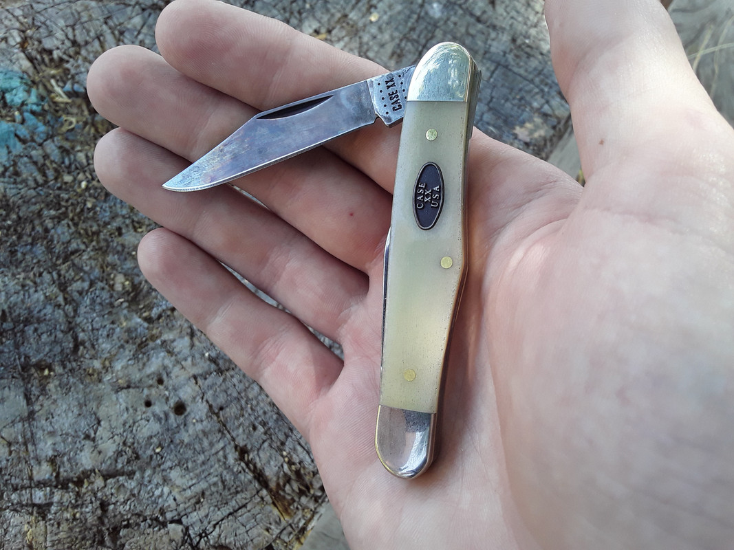

I love a forced patina or natural. But I am metal sensitive and can taste it on cut fruit so I don’t use carbon anymore. I used to. I had a near mint case Texas jack I forced a patina on. I heated the blade under my faucet on hot water for a minute and smeared lime juice on it. Waited a minute and rinsed. Repeated a few times till I got that dull gray I was after. Easy peezy.

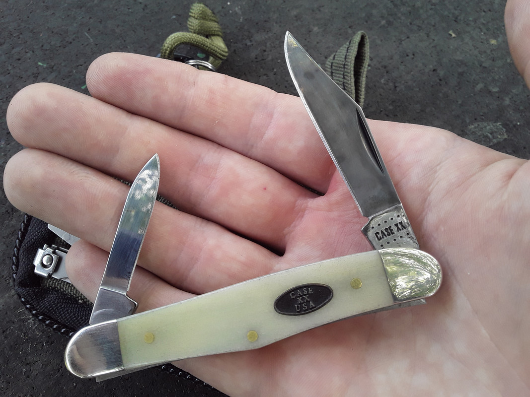

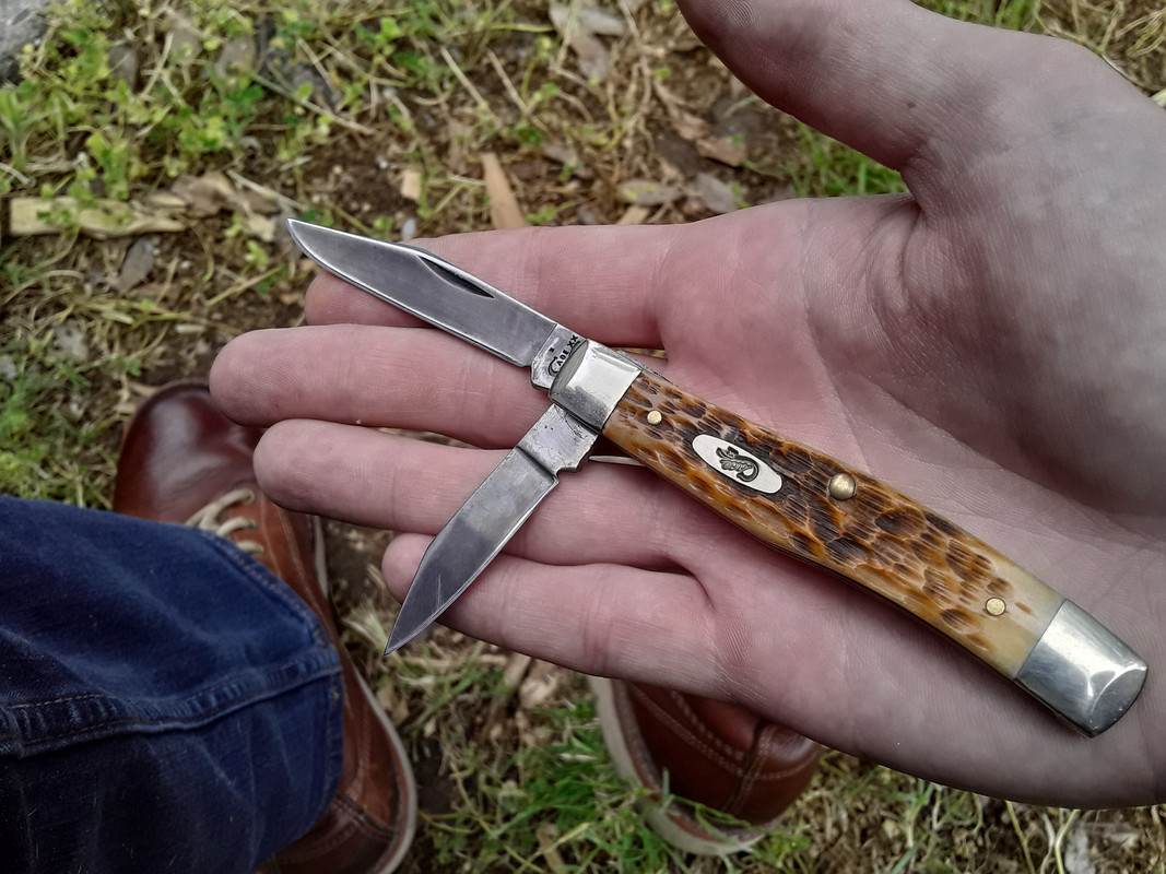

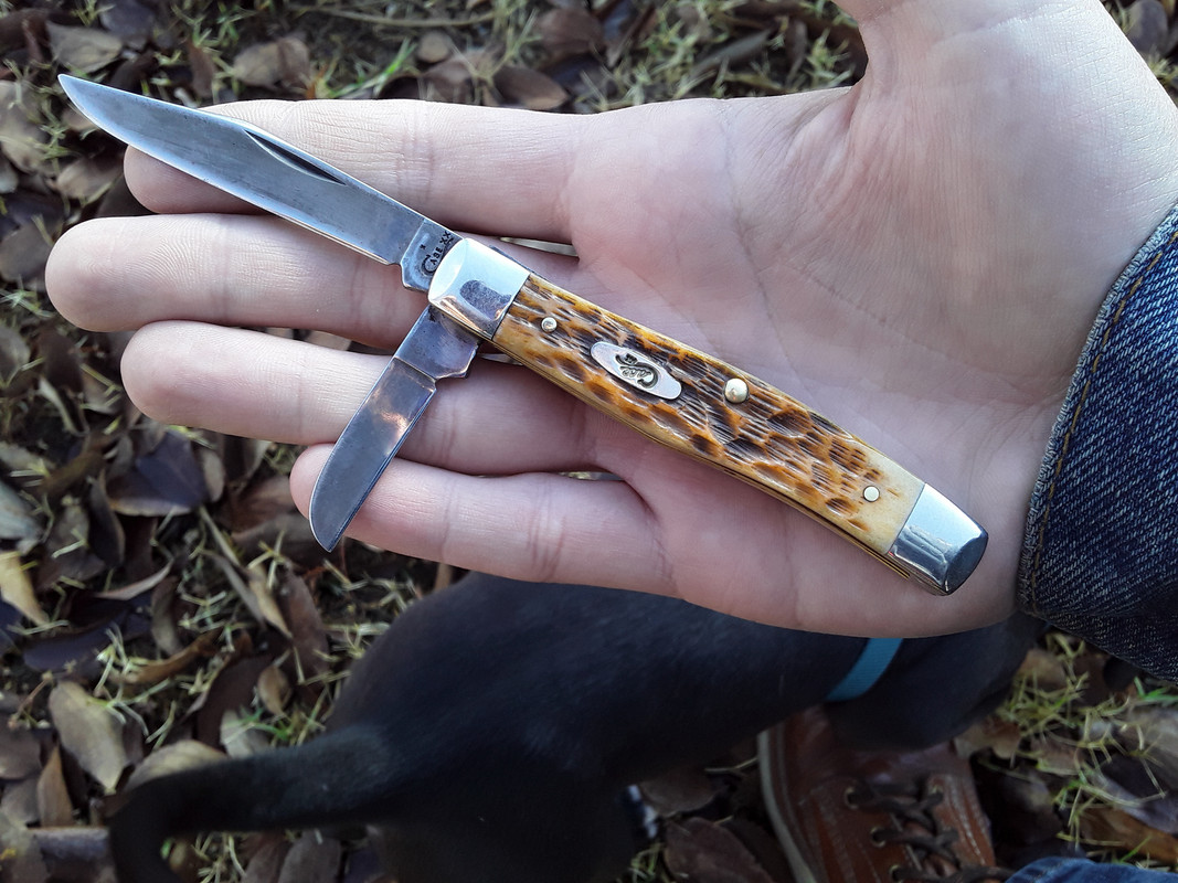

I used to force patina on my carbon steel blades, now I just use them for whatever comes up. The last vinegar dip I did was on my Douk Douk after having a Walter Matthau moment eating an apple... Now I'll just do a reset every now and then with some polish and see where things go. 1609287230935570157737.jpg
I cut a load of zip ties and stripped a bunch of wire today, just finished a touch up on the stones. It might get used on dinner later or cut some sausage tomorrow, who knows? I'm actually debating polishing it up this evening. The even grey has pretty much set in, I polish it every few months, whenever I get a hankering for some change.

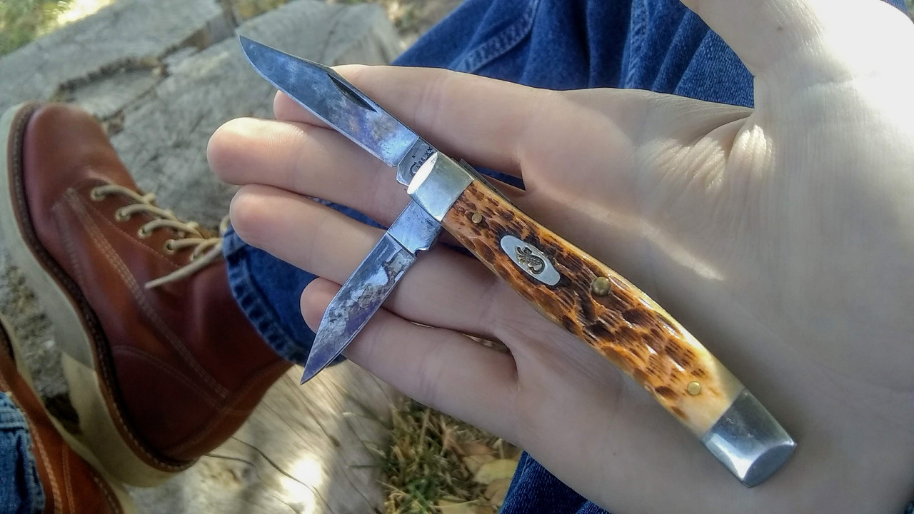

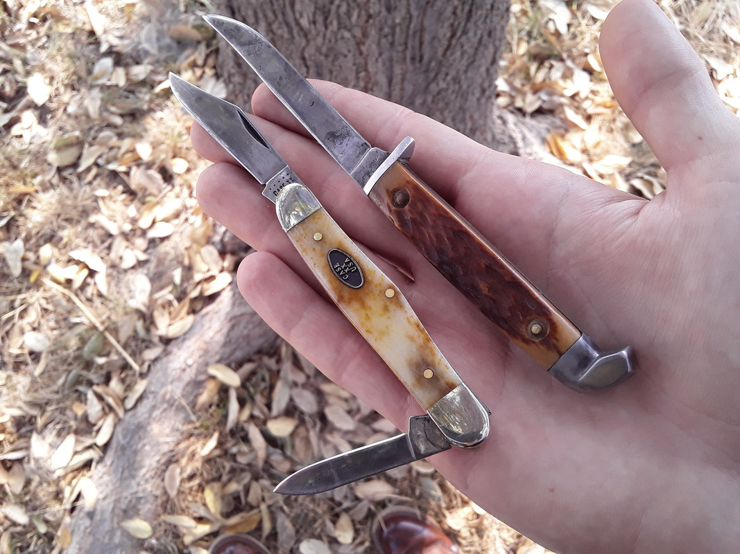

After reading various posts I thought I'd try something different so I stuck each blade in an onion
for an hour and a half and really like the patina it achieved. Not like some I see that just look like
very dark spots on the blade.
Onions make a great design, and yours looks really good! I did something similar with my Izula when I first got it, although your result is a bit better.
That was my first carbon blade. I was disappointed when the cool pattern I achieved disappeared after a little use. Now it's a fine even gray, which I love.

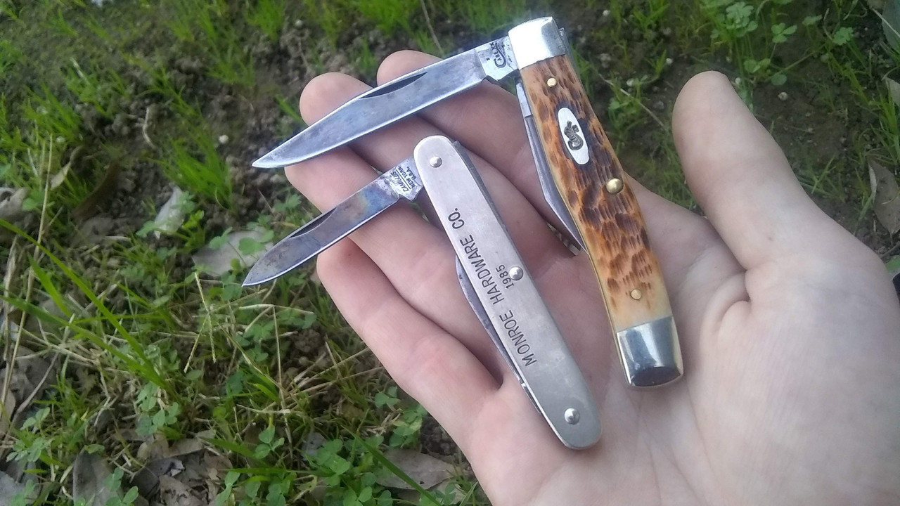

Have to agree, a fine even gray is a beautiful state especially when it's the by product of use and lots of time
The only bit of the blade to see polish is the edge

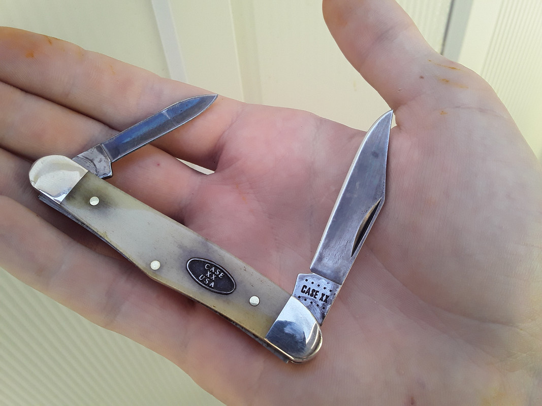

What's not to love about stainless or carbon with a patina of any kind? This one I "forced" (or sped up the process) by using a paper towel soaked in vinegar, heated, and wrapped around the blade for about ten minutes. It took two times of doing that for what you see.
