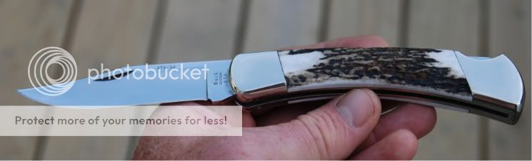

The steel is an improvement, the stag on mine is excellent, the action is smoother than on some of my other 110's. The blade is the same shape and size and thickness. It's a slicer, and can lose the tip to any kind of rough use. Great knife. I like it as much as my custom shop elk and BG-42.

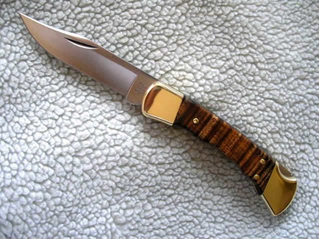

Here's my ATS-34/Elk with mirror finish and nickel silver bolsters from Buck's Custom Shop.

Very nice! I might break down and have the wifey get me an S30V one from the custom shop. Do you remember how long it took them to deliver it?
