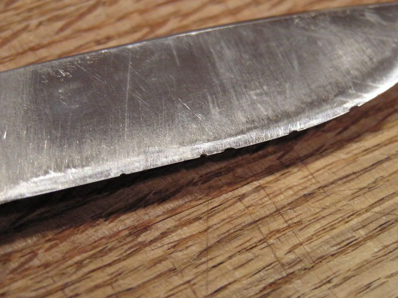

This is what happens when you put a high lateral load on the edge. This knife is D2, and I thinned it out too much.
http://i137.photobucket.com/albums/q203/sodak_photos/testing/queen_4180.jpg
A small microbevel took out the damage and gave the edge enough thickness to be able to repeat the test with no more damage, but lesson learned. I was carving a piece of fatwood, using the same motion that you would use to scoop ice cream.
How thin was your D2 edge?
Out of curiosity, I just scoop some dry pine & black oak with D2 blades I tested today - no problem.
cross link - http://www.bladeforums.com/forums/s...est-amp-arms-exercise?p=14484421#post14484421
Way too thin. I don't remember exactly, but it wouldn't surprise me if it were under 0.015 inches, I was really pushing it back then. It cut very well, but needed a little more support. If I could have had it re-hardened to 61 or so, it might have been ok, but a different steel probably would have been a better choice...
To be clear, this was completely my fault, not the knife's fault. I still use it today, and it's a great performer.
