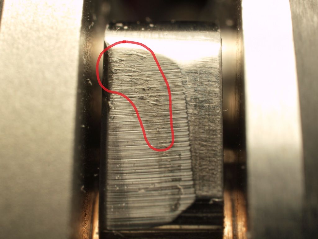

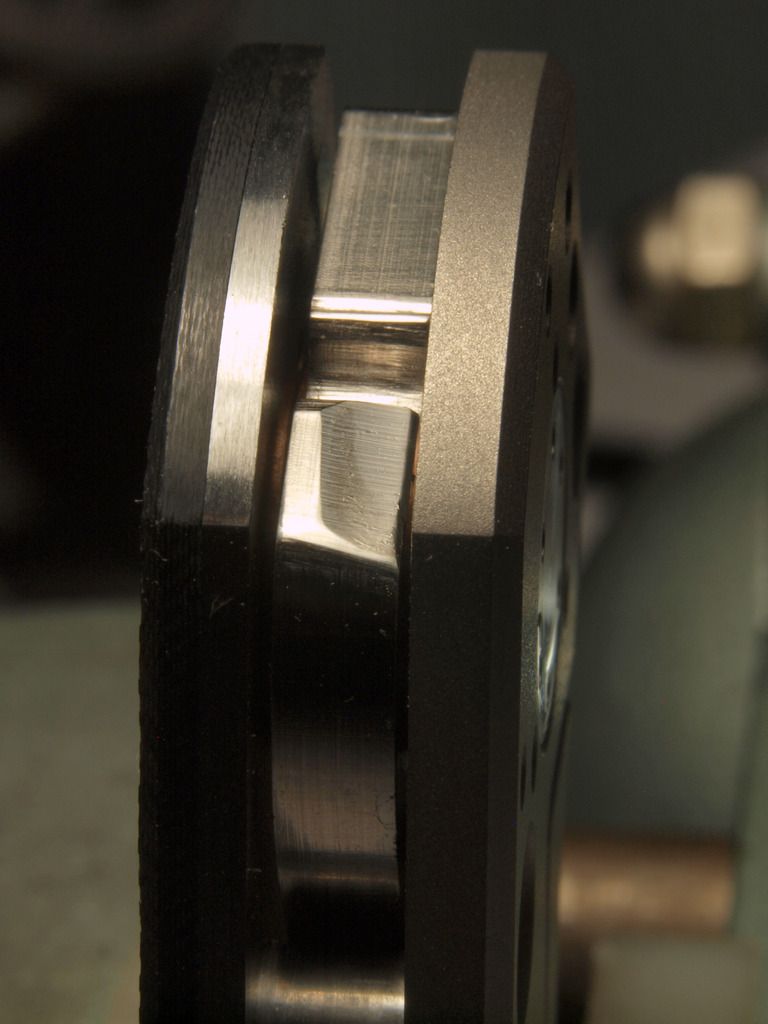

I have a LNIB (been out of the box for inspection - so not NIB) that was a factory replacement for my first one that had a bit of lock geometry issues (pic's below of my first TUFF), and resultant lock-stick and also an overly stiff detent that made opening the knife a dedicated event. The replacement I received from Spyderco is a stellar example of the TUFF. I had planned to mod the original knife (bronze or blue electro-anodise, etc. and thin the grind down), but due to the factory build quality on the replacement one have chosen not to modify yet and have not even carried yet. A nice example of Taiwan quality potential.

Pic's below represent the issue that was creating lock-stick on my first TUFF. This was barely noticeable without magnification, but lock-stick was obnoxious, as was the overly stiff detent. I was able to pin-point the issue (related to lock-stick as being a manufacturing issue) and illustrate in a letter to Spyderco with pic's and surprisingly they graciously set me a nice replacement example for my efforts. It took over a month, and I am not sure where they pulled this one from, but I think somebody was saving it ... as it was discontinued and out of stock at the time. I was lucky to say the least. It's been in it box since 2014, with only occasional appreciation handling & consideration for modding.
This is NOT Ti transfer from the lock-bar, it's an issues with the grind of the 3v on the lock-face of the blade-tange (BTW, lock-bar has S/S insert). Metal swarth transfer from the grinding wheel in my mind. No blame on Spyderco, just something that slipped through QC.
