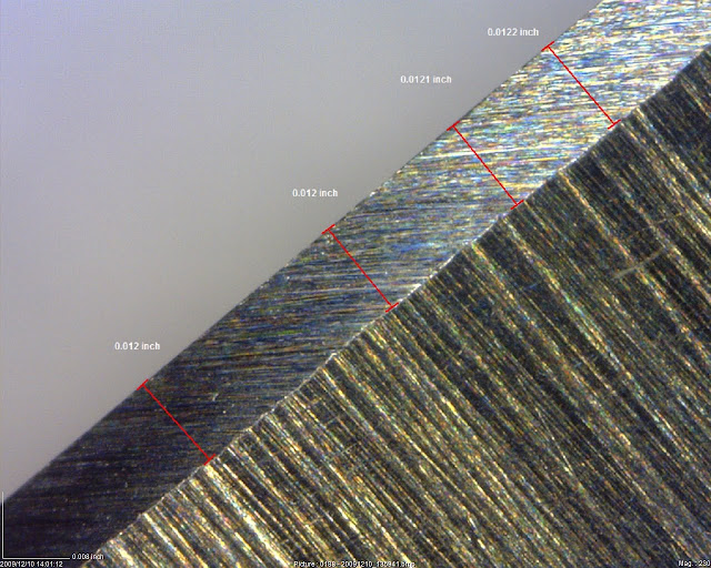

I was referring specifically to angle of scratches in relation to the cut, so the scratches will all be nice and uniform. For instance, take the edge from your first picture. I was questioning if that same edge would cut the same when slicing from either direction.
