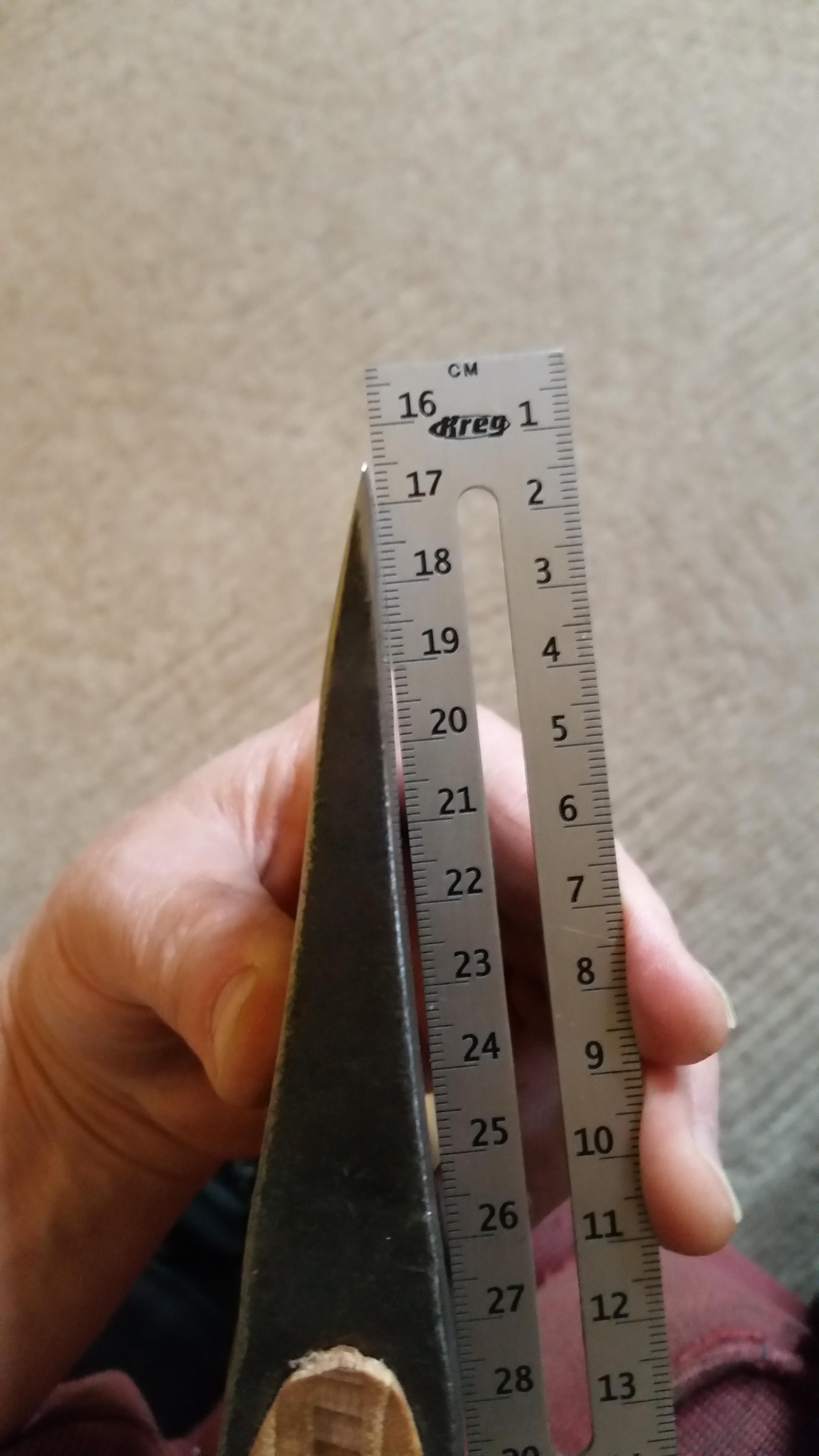

I recently purchased a Wetterlings Bushman. I like the size but the ground seems a bit uneven. One side is a bit convex and the other is almost straight. If someone could tell me how to post images I'd like an opinion about the grind.

on the grind, I will give my opinion; my opinion is free and probably worth about what you paid for it. :) I do see a slight difference from the left to right side and since this is a hand forged axe, slight variations are to be expected. I don't think it will affect the performance of the axe at all and I wouldn't let it bother me. Your pic doesn't show the bit to handle alignment; assuming that is good, then I would put it to work.
Keep in mind that my go-to axe is a 1950 Sager Chemical DB that cost me about 1/6 of what your Wetterlings did, so I might not be the best person to ask. :)

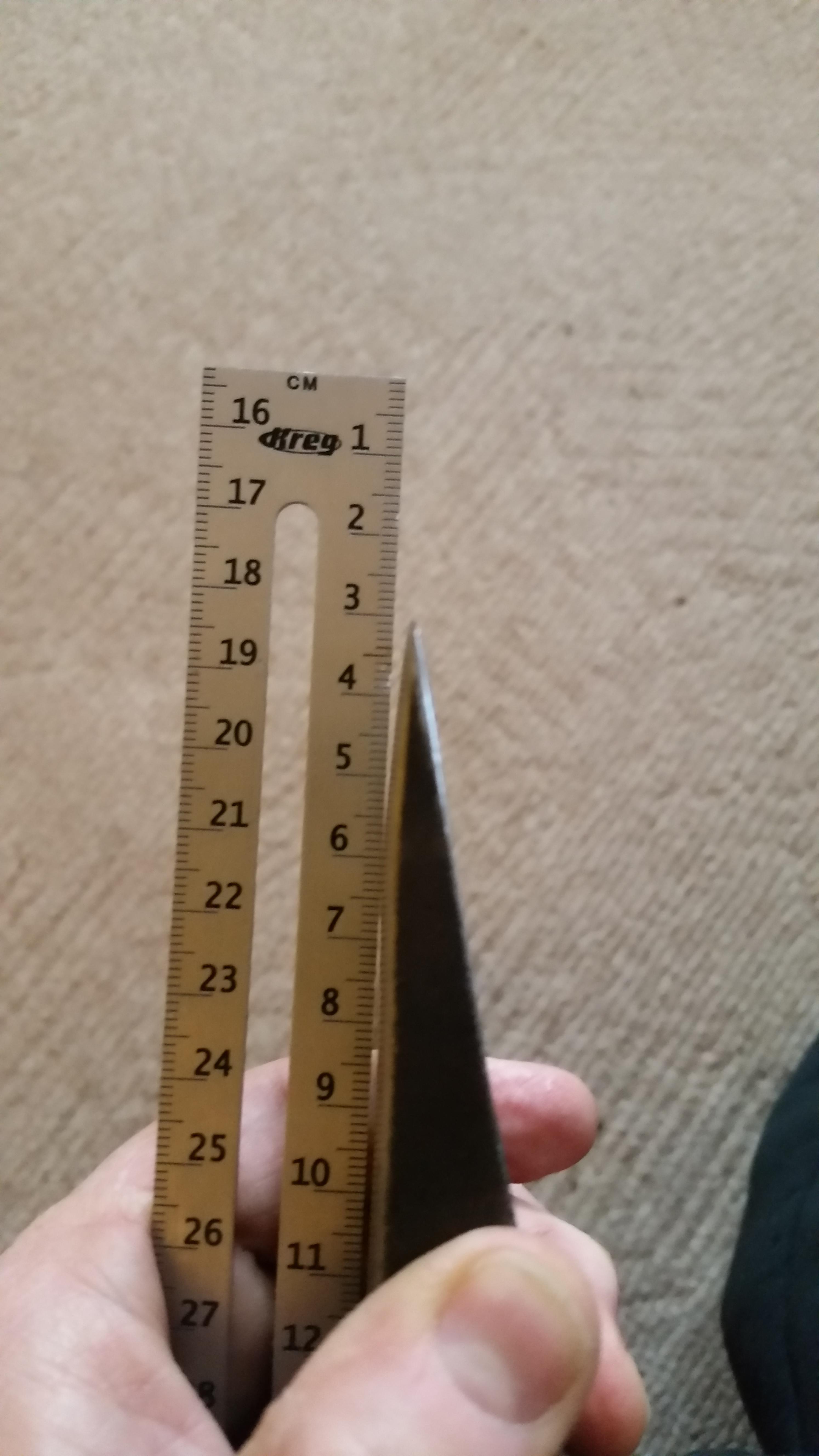

Here is the other side work a rule.
Tv3K6yH
I'm trying again to post the image of the rule on the right side.
one more try.
Get hold of an axe file and keep at it until you're satisfied. This is going to take awhile. IMO disc and bench grinders are way too fast and not very subtle when it comes to creating gradual tapers.

A file certainly gives you more control of the process. I'll sometimes thin the cheeks with a powered grinder but the finished shape and actual edge is reserved for file work.

Ditto! Keep in mind if you concentrate on the branch or tree while chopping you will never notice a very slight difference in symmetry of an axe blade anyway. A power angle grinder can really speed up an initial reprofile but never 'go to town' with one and do not ever figure on taking file work out of the equation.
I believe they are ground by hand after forging. I wouldn't let it bother me. I would use it and gradually get it into shape as I sharpened it.
Most used axes I get have asymmetrical grinds- some knife makers bank their reputation on them. I would not say a slight difference is anything to be concerned about and fixing it can be very satisfying and good practice.

OK. Thanks, guys. I won't sweat it. Any particular file you might recommended?
If you have local flea markets- for .50 -1.00 you can pick up old Simonds & Nicholson Black Diamond files. Mill Bastard/ Smooth Bastard are my most used. Multicut and Magicut are two coarser files but I rarely use them. Larger the better for a nice long stroke. I like a small half round for cleaning up burrs at the top of the eye.

Nicholson makes specific "axe" files (single cut on one side and double cut on the other) with wide flat handles. These implements have been good to me over the past 45 years but the ones I have say 'made in Canada' (Cobourg, Ontario) or 'made in USA' on them. Newer Nicholson versions are 'hecho en Mexico' and apparently not revered to the same degree for hardness and durability. For an investment of $10 though a new one of these will get you well on your way to discovering that perfect symmetry is not so easy to attain.
