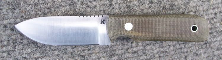

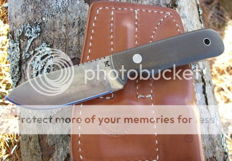

After a year of carry and use. Cutting everything from wood to food.
There are ways to force a patina. I have never tried any of them, I prefer to let my carbon knives earn their patina.
Same knife..the day I got it..
