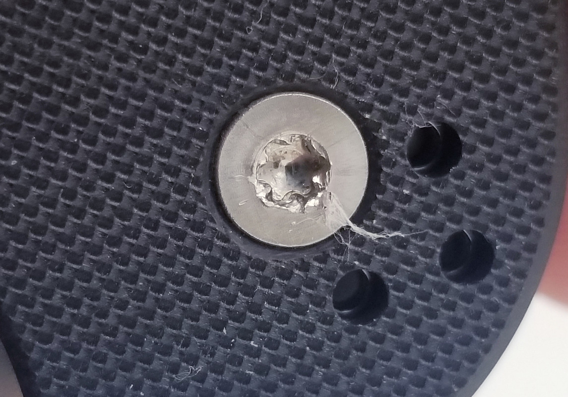

Hi gang!
Got my Para 3 yesterday. Awesome little knife, I love this thing!
Only one issue though. One pivot screw came mangled. I put my torx bit in it just to see if my bit would bite. It seems too. I didn't apply torque.
My knife is perfectly centered. I'm just concerned that if the pivot loosens up I won't be able to adjust it on that side. If, however, it's loctited in, I know I won't have to make any adjustments for a long time.
The screw has a sharp raised area that you can feel. Whoever put this screw in should have backed it out and put a fresh screw in place. I've had off days too though, haha
I love the knife!!!

They used to red loctite the pivots; but that practice has supposedly been stopped. Whether it was before, or after, your knife was produced, I can't say (Time is a blur; and the PM3 isn't a knife to which I've paid much attention - bought one for a friend...he didn't like it, I didn't want it; so I turned it loose).
Ask for an exchange, since you received it that way; or contact Spyderco and have them deal with it. If you want to deal with it yourself, treat it as if it has red loctite.
Yeah, looks like somebody used an oversized Torx driver on it, that's why your T10 might still work. Unacceptable for a new knife. These screws are hard to find in the open market (100 degree cones), at the minimum, Spyderco should send you a new one.
Most Spydercos I've handled had blue loctite on the Pivot screws.

As others have said, that should never have left Spyderco's factory or been sold publicly with a screw like that. Locktite or not, it's horrible looking and unacceptable. I would return it immediately to the place of purchase.
For the record, all my recent Spyderco purchases have used what appears to be extremely weak locktite on the pivot which takes very little force to break free. These have all new been new-ish models, including a Para3 S110, Para3 Maxamet recent production, Para3 SPY27, Manix 2 DLC M390 edition, and the Shaman Z-Wear I received two days ago.

I haven't bought one in maybe a few years, things might have changed. But my experience has been they used blue loctite. If that was new from the factory, I would send it back asap. Especially coming brand new from that dealer and paying full price. You'll eventually have to break it down to clean it, stripped screws can sometimes be a PITA. If you stripped it, that's on you, ask the factory for screws.

Hi Billy,
like I said, these days, it's mostly blue loctite. In the old days (years ago), it was red. In any case, a good Wiha driver will open the Pivot even with red loctite, so have no fear.
You can tell if the screw is too loose via blade alignment. If the blade is centered or leans towards the lock-side, the Pivot is tight enough. That's how I do it anyways.

If it was mine I'd send it back or see about a replacement screw. But... if they won't take it back you could remove the screw, place some 320 or 400 grit wet or dry sandpaper (wet) on a very flat surface and sand the screw flat again. It would probably clean up very nicely.
OP - obviously you are one of the easiest customers to deal with ;) That mangled pivot screw alone would not make me happy with the knife; it does not matter how great other aspects are. I'd ask for a replacement from BHQ.

It sounds like someone returned that para 3 after mangling the pivot screw. If done at the factory, they would've had plenty of screws on hand to replace it with. It doesn't matter if it's going to be a user or not. You could've purchased a user much cheaper on the secondary market.

I can tell why it happened now. The knife developed blade play today. I loctited the pivot screws in. If there was any type of loc tite on them, I couldn't see it. I couldn't get the play out of the knife without making the action too tight. So I'm guessing some kid cranked down on the torx screw in frustration trying to get the adjustment just right.
I may just return this one. I seem to have bad luck with the Para family. Lol
