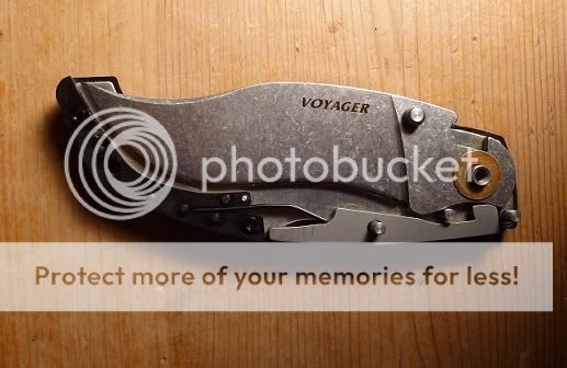

No and no. By design, so not to worry - only opening and closing repeatedly can cause hand fatigue.
It causes very minute wear on the lock mechanism only. You might see a small line on the blade tang ricasso area where it contacts a pin on closing.
In this photo of a Voyager it is the middle pin, in between the stop pin and the lockbar pivot pin.

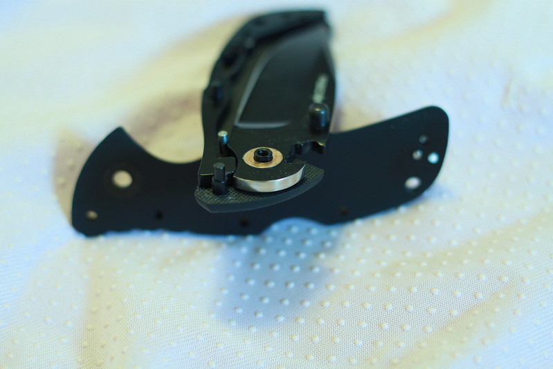

Here on a Mini Recon 1 you can see the blade come to rest on the middle pin that is satin/natural finish.
No, the blade edge doesn't hit the handle, so no it won't damage the blade.

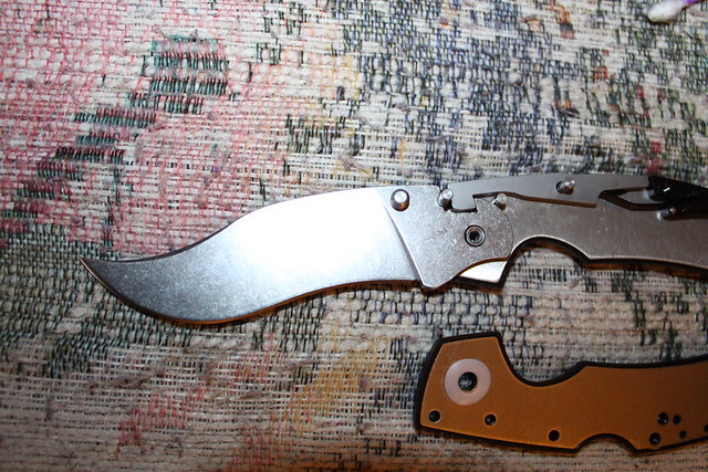

The knives hit a stop pin, so they don't go too far one way or the other.
But the knife rests well in the handle with no damage to the blade.
It depends on the design of the individual knife in question. Some, like the Buck 110, can snap shut with enough force to let the blade strike the lockbar, spring or spacer, which will flatten the edge at the point of impact. Others, like those shown here, are designed to prevent that. It just depends on the lock geometry.
I think the folks have answered your question(s). No, the blade edge does not hit the back of the frame.
