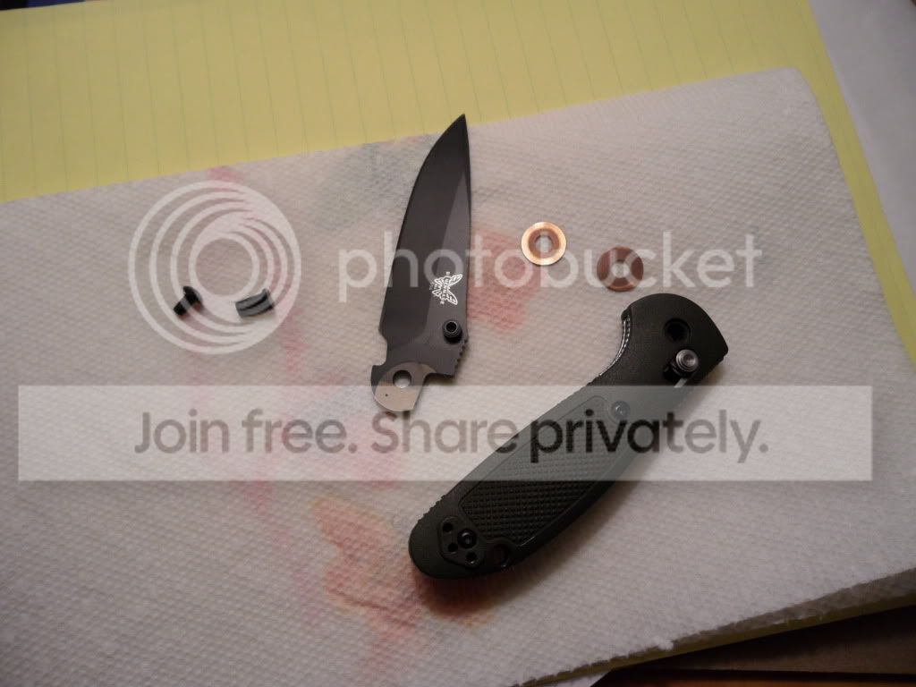

Affiliated question: How hard would it be to strip the blade, and how finished would it be underneath the coating?
ETA: By this, I mean the entire blade. I've stripped plenty of knives, but I've never disassembled an Axis-lock.
You can do the Benchmade customize a Grip and have any combo you want. Any steel choice, handle color, clip, and hardware finish. Sure it'll cost you more than a standard Griptilian, but you can have some cool combos.

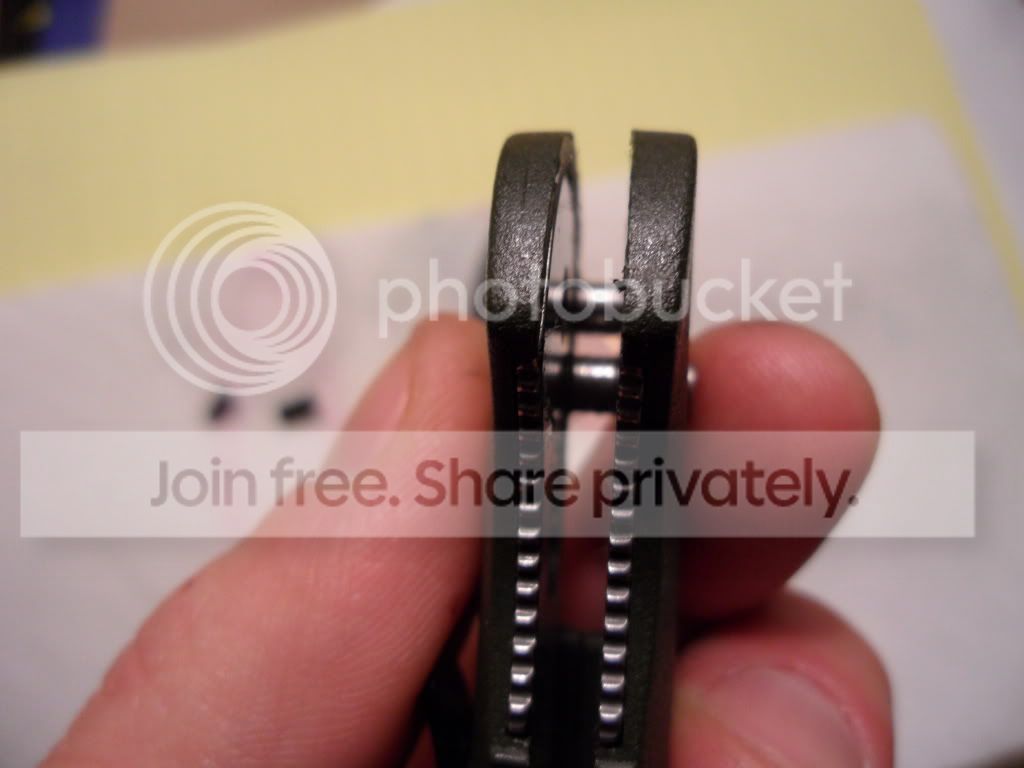

As for stripping the coating, I think it would definitely be much easier than, say, the ESEE coating to strip (tough son of a gun). I think you can disassemble a Griptilian for a strip job by just removing the pivot screw and sliding the blade and washers out. I actually planned on stripping the coating from my coated D2, OD handled Mini Grip. If I do, I'll let you know the details involved.
Edited to add: It is possible to remove the blade without fully disassembling the knife and it is just as easy as it sounds. It took me all of 30 seconds to take it out and another 30 to put it back in.
My blade and clip are sitting in some Jasco right now. I'll post pictures when it's all done.
An update on this; the coating is far tougher to remove than I had thought. After about 30-40 mins in the Jasco, the coating has barely been affected. It is by far the toughest coating I've tried to remove so far. The ESEE coating was affected after the same amount of time in the same stripper. I'm going to let is sit for a bit longer and check back.
OB, your response was heads above anything I expected.
If that coating survives another round in the Jasco, I'll just get a coated blade, safe in the knowledge it ain't coming off anytime soon. :p
Biscuit, it survived barely scathed. The only removal done was by scraping with a razor blade. Even then, it just looks like a used blade and not near a stripped one. I might give Citri-Strip a try tomorrow.
