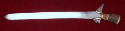

It is thought that the Moro kris evolved from the Indonesian keris. My first picture shows an archaic Moro kris from the mid 16th or early 17th century. The side plates are not usual, but are a vintage restoration.
Moro kris come in either waved or straight configuration. It was thought that the straight blades were better for slashing.

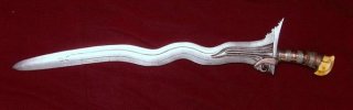

The second example is also an archaic Moro kris. Not quite as old. More likely 17th century. Note the half waved blade. Some people conjecture that the blade indicates a Naga or mythical serpent. the straight blade is a Naga asleep or in meditation, the hald-waved blade, a Naga in transition and a fully waved blade as fully awake.
Kris and keris are considered masculine and therefore do have an odd number of waves or "luks."

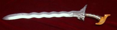

The third example is a high end battle blade. Well made, but simple.
The fourth example is the one in my avatar with a larger ivory pommel. This one likely belonged to a chieftan -- Datu or Panglima -- noble or perhaps just a wealthy man.
