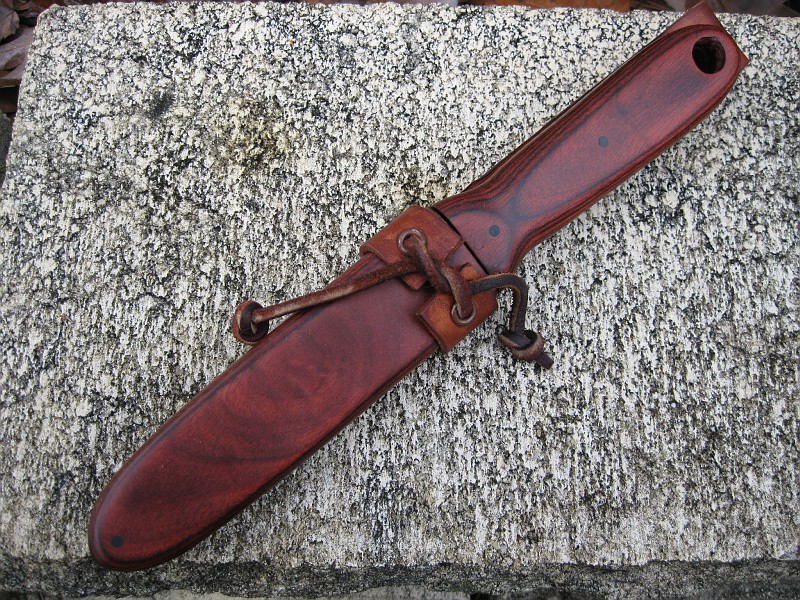

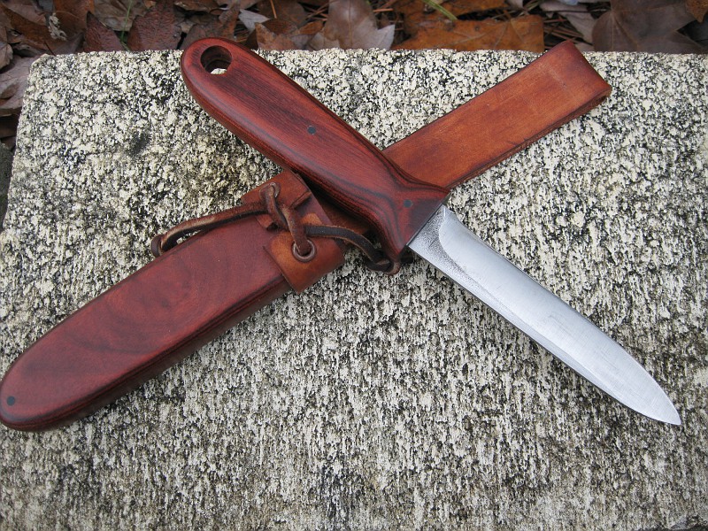

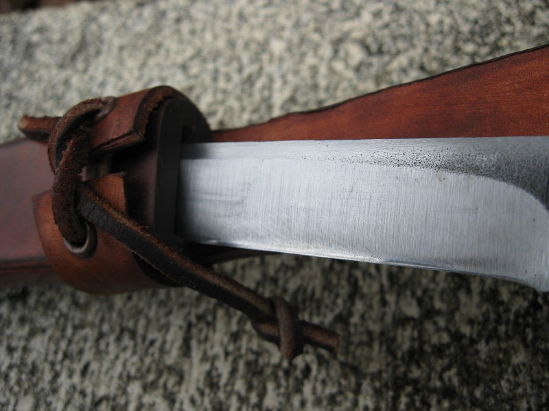

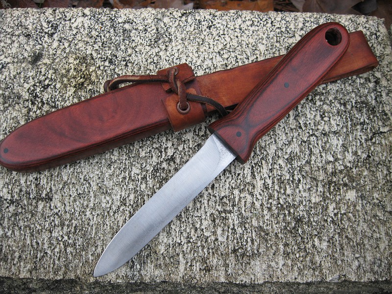

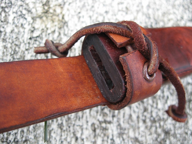

Here are a few pics. The ones of just the knife were taken at home with my camera after cleaning, straightening and sharpening the knife.

Now, on to the hike. And let me say that Dan did give permission for me to beat the hell out of the knife if I chose to do so. I didn't go crazy, but I did have some fun! Along the way, I was able to Baton, Bore, Whittle, Cut and then Strike a firesteel. None of which, I do on a regular basis or with a whole lot of experience, so again, please no chuckling. With limited time, the available wood for battoning came down to a small pine tree that had succumbed to high winds and snapped over. I found a small limb nearby to batton with, and went to town. Cut through a couple of times to get a few 3-4" lengths. The knife held up like a champ. I really beat on it, and at one point, thought to myself that I would for sure damage at least the handle, possibly separating it. Nope, it was a trooper. Mistakenly though, I tried splitting one of those lengths, and found the wood to be too long and too dense. This is where inexperience gets the best of you. I backed the knife out, and came up with a small bend in the steel. Additionally, while inspecting the blade, I found some small dents in the edge which likely happened while battoning. Andy recently commented on being careful not to baton wood with pin knots. I am not familiar enough with this so, I would say this is likely what happened. No worries though. At home, I was able to roll out the dents with some small round metal stock, and straighten the blade.
