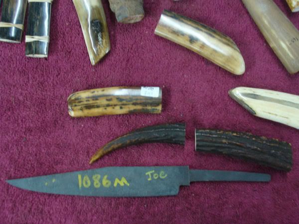

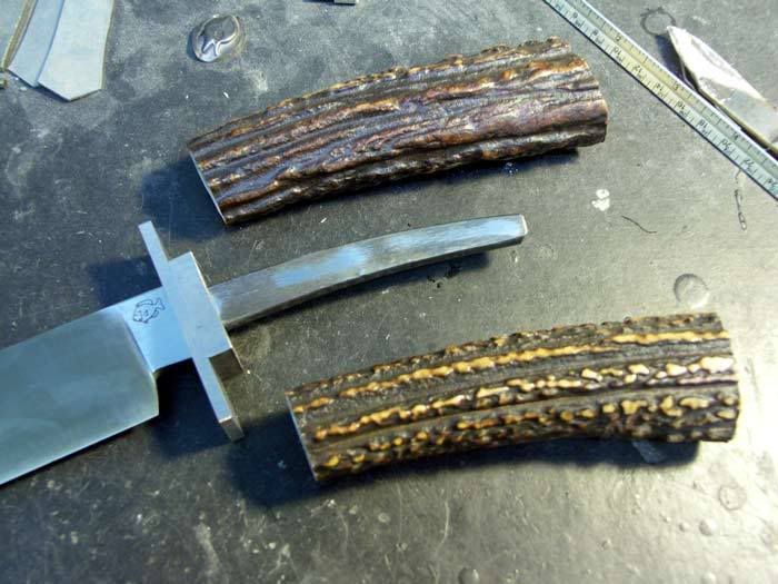

The 1086M blade in the first image has had my name on it for some time. Don called after the Blade Show and said my name was up to finish this. Don was kind enough to take a few pictures through the construction. We have discussed using stag from the start on this 9-inch steel and the first piece I picked (pictured) was too large for the blade.

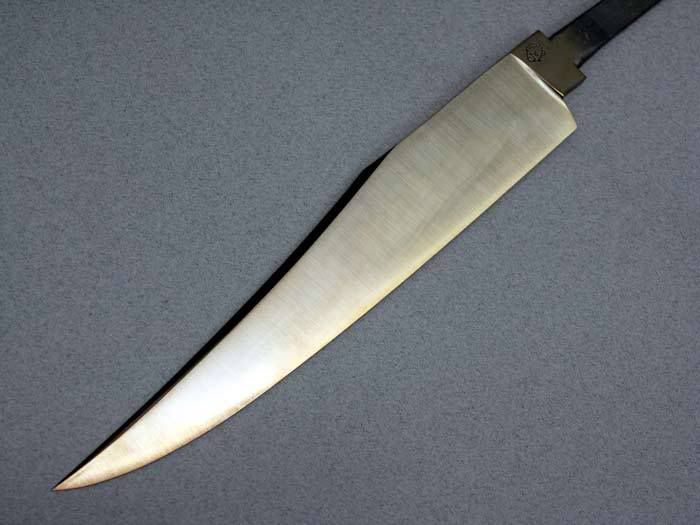

Don suggested curving the clip somewhat and I agreed. Knowing the tip would drop during heat treatment, he hammered the tip up some after grinding in the clip and it dropped into place during the one and only heat treatment. Good shot, Don!

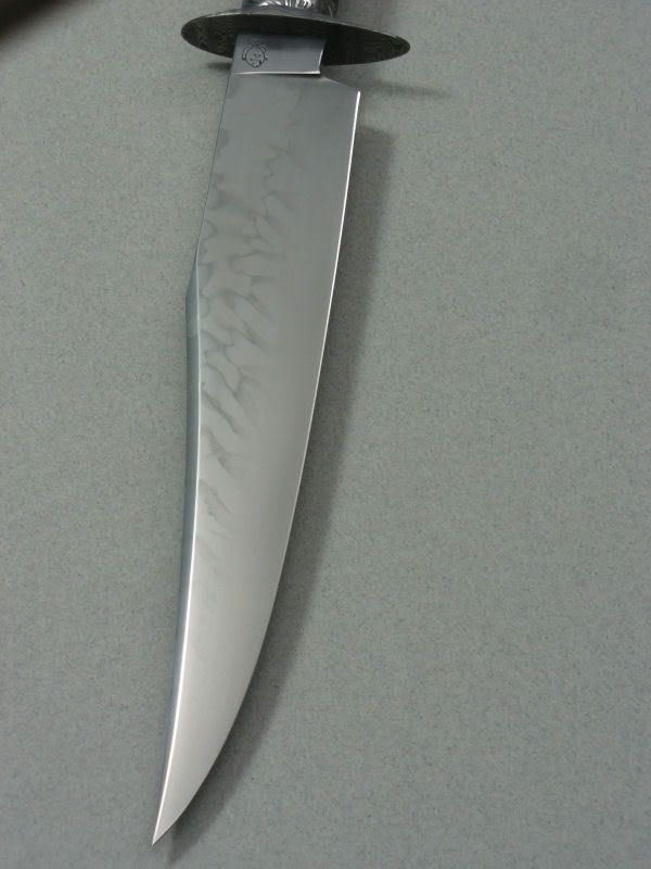

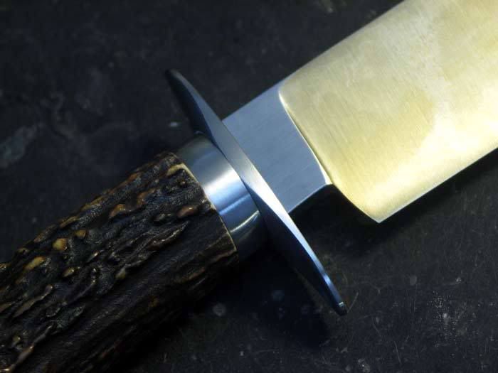

Guard and ferrule damascus pieces fit to place before final shaping. Still looking at stag.
The damascus guard and ferrule to shape, rounded well to accommodate the stag that was decided on.

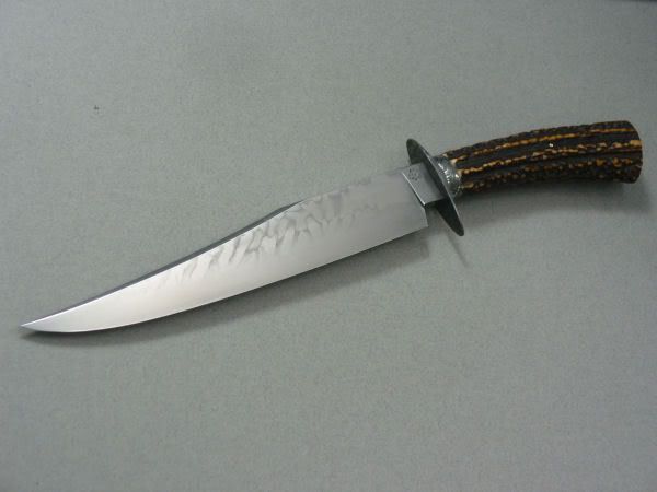

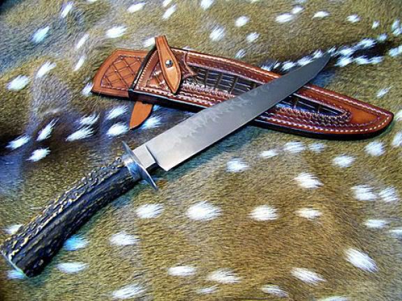

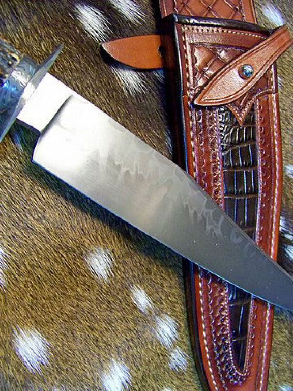

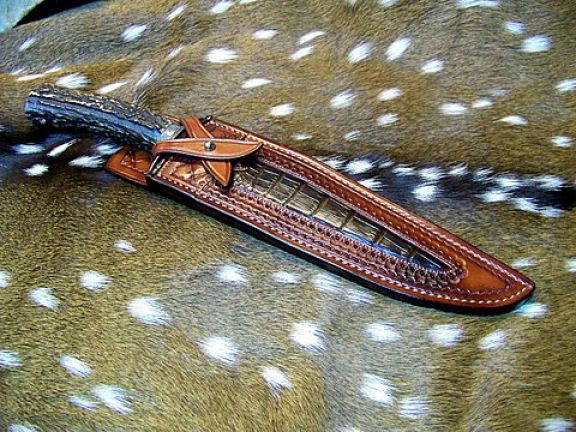

Some finished shots, next...and the sheath.
