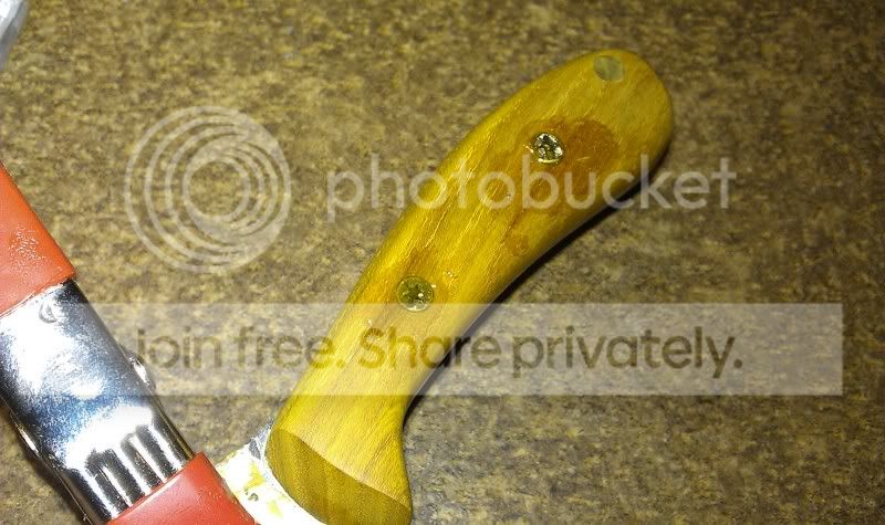

Anyway, I accomplished a fair amount today. I got the handles on the Case sanded down and almost complete. I'm ready to add my pins, but I can't decide if I want to go with some brass and stainless mosaic (it's a brass tube with black epoxy and round SS rods that go around the inside...not terribly fancy)...or just some flared stainless tubing in the 3 holes. I'll get pics of the handle in a bit, my camera is my phone and it's also my internet connection lol.

Ok, so I went with the mosaics :) Here is the handle drilled and ready, then mosaics inserted and epoxied. I got a little wide with my holes so I mixed some of the yellow dust with the epoxy to help mask that.
As soon as this dries, it will get a brass thong tube and final finishing begins.
I love this stuff. It has become one of my favorites to work with. Now, if I can learn the fine art of "toasting" it to bring out the grain in those awesome reddish brown shades!
