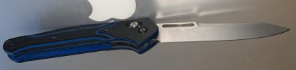

After 6 years of studying the 940 as a hobbyist, gathering and trying parts, this 8 months of waiting is over, and my reblade is in hand, WOO-HOO. I am trying to make a great knife a great slicer while retaining the Osborne over built design, taking the opportunity to compare steels, designing a warm aesthetic using burled Carbon Fiber scales that fill my hand with a swell sized to the 940. Yeah, like the excellent "Grip" tillian scales.
Went thinner on the idea that Magnacut's toughness could go from stock's .0114 to .09 inches and maintain plenty of EDC blade strength; My impression from Larin was that RC 61/62 was good to go for folders, and this blade's 61 more then matches the 940's pivot / frame strength; 0.009 inches avg. BTE is reasonable for a user, and will help slicing; retained Bronze Phospher washers for longevity and ease of service, though NP3 or DLC would increase lubricity; hollow ground helps slicing and stays thin BTE longer. A most happy error occurred when the opening slot droop matched perfectly the dip moving forward along the spine to the start of the drop point. This aesthetic makes me smile, and I cannot tell you how many times secondary gains eclipsed primary goals project after project.
CF scales with Burl inlays like DOAT makes would work. Though the beauty of 3D machined CF with lower, inner, and upper, top layer, latticed like a Dmitry Sinkevich Custom Coordinal Leafe might be better for getting a little rounder hold on scales approximating the Griptillian. Of course topped with burl, maybe next year.

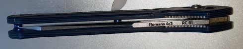

Hoping Rogue River Blade Works will run another batch of 3D CF clips, which are 1 gram and beautiful. I expected a makers mark as standard, but blade was only marked with my life verse "Romans 4:3" and blade's tested "RC 61." Thank you Dylan and Schenk Knives.
Fitting and sharpening this weekend, guessing secondary bevel width will be closer to my Shoki's ~.025" at .015" BTE then a Bugout's ~.035" at ~.020".
Assembling my 940-1501 s20v blade in a "parts cow" frame for comparison next.

* Disassembled- weighed n measured: stand offs, blades, clips.

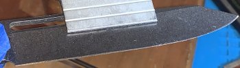

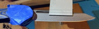

* Created the secondary bevel and apex on my new Magnacut custom blade (.09” at .009”BTE): easily slices gas pump receipts, does not push cut every time, off KME 300 grit diamonds.
* Magnacut blade sharpened at 32 degrees inclusive using KME 140 119 MICRON and 300 GRIT 57 MICRON diamond plates; thumb only pressure with leading and trailing edge combined first (~80 minutes including breaks, edge and angle checks); then stone holder only, then trailing edge only, in decreasing strokes measured first in 5 minute chunks then toward finish with stroke count, down to 3 each side.
* Thank you Benchmade Engineers: tight tolerances and parts keying and registration, made frame reassembly easy peasy -oval shaped stand off anchor and strength bulge at standoff screw anchor point.

Funny story- reading about shifting angle reports on various threads got me seriously concerned when checking sharpening angle, which I stopped doing since growing confident with KME, instead checking 17 degrees a bunch, both ends and middle, then I see 20 degrees. Minor moment ensues, checking this and that, stop for a moment to look, and discover base had climbed on top of a raised edge on silicon matt… moved off bump and angle measures 17 degrees, crises averted. As always never deviates for me unless I'm not paying attention...
Off KME 140 grit 119 micron edge
Off KME 300 grit 57 micron
Yes, I wanted to carefully create an excellent even first edge on the blade, so the KME is my best tool for this job.

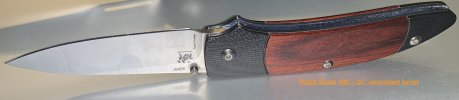

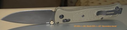

Here are three pics of a Bugout 535, my 940-1501 Magnacut, and a Shoki 480. The 940 has a slightly smaller secondary bevel then the 480, ~.20 vs .~25". Both 940 and 480 are much smaller then the 2 Bugouts ~.60 to ~.53", previously reported ~.35". The 940 is now below my threshold for estimating Behind The Edge - BTE measurements with calipers.
Serious distraction note - I am not at all satisfied with estimating secondary bevel width using my calipers. What is worse is that from different perspectives my eyes do not agree sometimes with my many attempts at measuring. Thinking my eyes and calipers are good-nuff, I have resisted measuring accurately with NIH IMAGE / ImageJ, a free tool I know how to use, or Gimp, another free tool, that has measuring and plugin functions I've never used. But accurate secondary bevel measurement would give me the ability to also report BTE measurements for my 940.
Reblade940aproxsecondaryBevel_v12.jpg480SecondaryBevel_v15.jpgstock535aprox2secondarybevels_v9.jpg

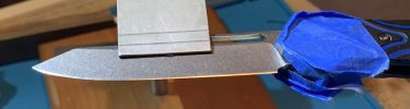

I just went after a 940's new Magnacut reblade for the second time with KME's 300 grit diamond using a gentle hand, stropped trailing edge on corner of soft plaster table, inspected with 10x illuminated loup. The 940's edge push cuts gas station receipts and standard 20 pound printer paper in my non-humid environment, on its own weight, but slicing revels "micro" serrations that catch on receipt edge. At 20 n 30x it is obvious apex / edge is rough.
