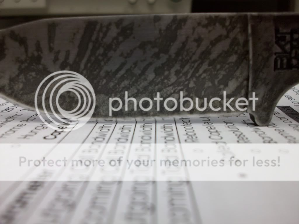

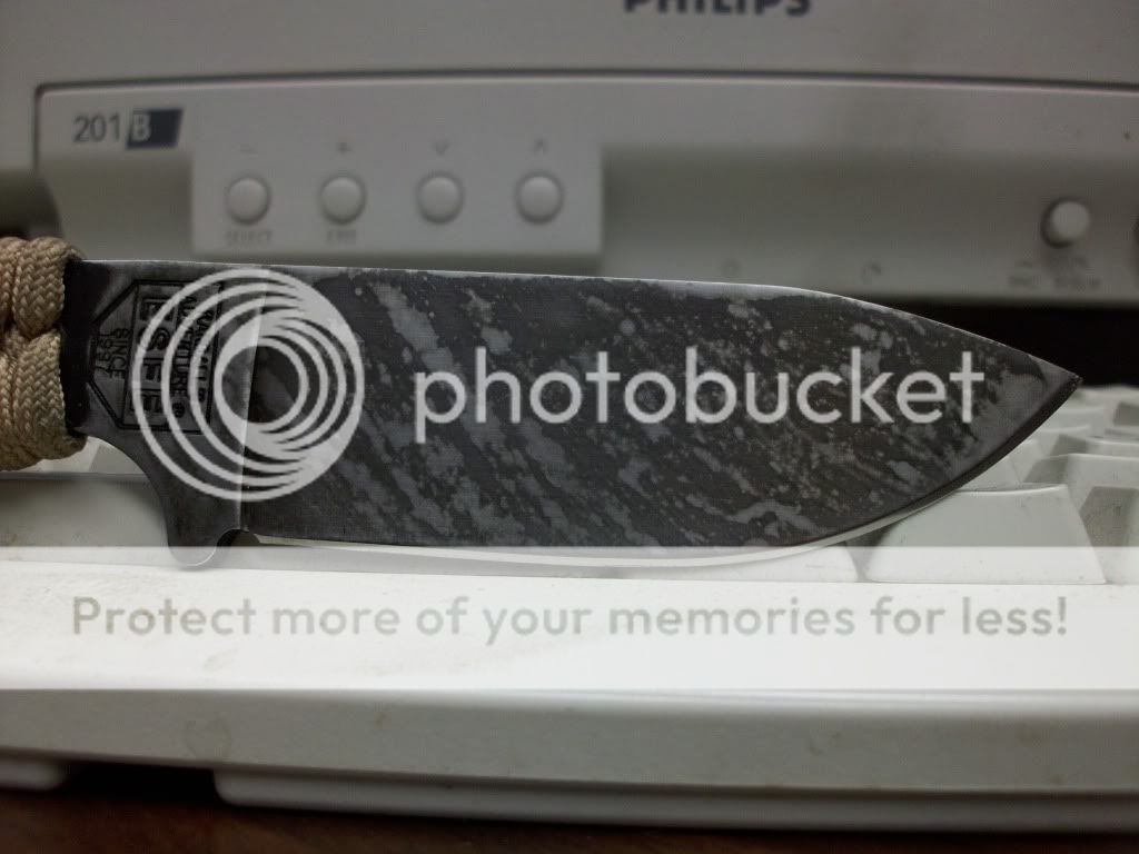

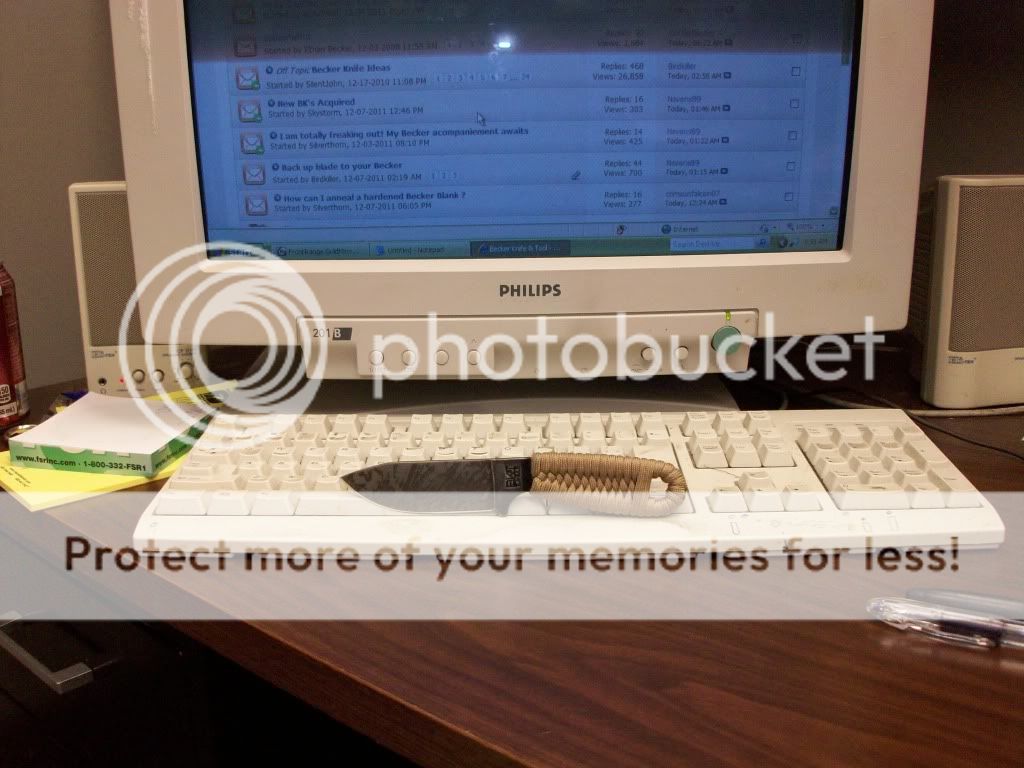

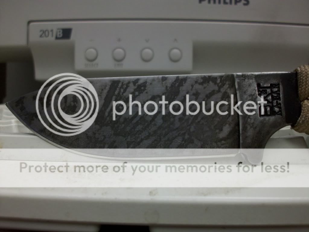

I was going through, doing my usual knife checkups last night, when I realized I haven't seen my BK14 in a little while. Got to thinking about the last time I used it, and I remembered where I left it, on my Nalgene Murse, which, was with me on my last outting. When I got back, I just threw a bunch of my gear in a corner, with the promises of "taking care of it later". That was 3 weeks ago.
So, I found my beloved BK14 right where I had left it, pulled it out of the sheath, and TEH RUSTZ!!!!!!!
I had cut up some meat, veggies and fruits, and just threw it back in the sheath. Plus, I got rained on pretty good on the walkabout, so it had been sitting there, rusting in place for about 3 weeks. TEH RUSTZ!!!!one!!! O NOES!!!!! Big, flaky, orange rust. No big. :D
So, first step, was some 00 steel wool, some mineral oil. Knocked the heavy stuff off, which left an awesome patina, but it was too much of a contrast for me, so, out came the 400gt W/D sandpaper. A few minutes of sanding, and it was shiny and new again. So, I kicked up to 600gt, then some 0000 steel wool. It was even shinier. :D Can't have bare steel, so, I put a patina on it. And here is the final product.
Oh yeah, figured while I was at it, might as well throw a new, polished edge on it, and get her ready for some action, got a busy weekend planned. :D
So, think your BK14 is as sexy as mine? Don't talk about it, prove it. :D

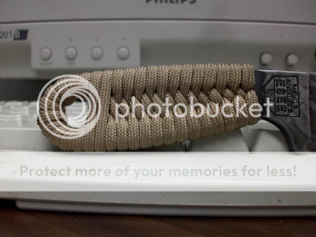

I dig your wrap . It's so nice, even my wife would like it - She loves all those weaved Rattan storage boxes from IKEA :D
