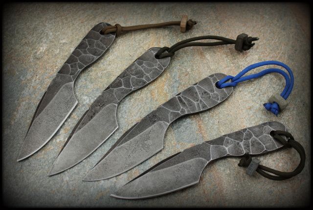

For those that don't remember, here is a pic of what the finished ones will look like.
They look great, (like all of your BPKs,) but why the steel and thickness? On a light, minimalistic design like this, I'd think that 1/8" 154CM would be a better choice.
Thanks guys!
I went thicker partly because I can't carve thin steel like these. Also these are meant to be an all purpose hard use tool. I have made thin ones in the past and they have never sold for me.

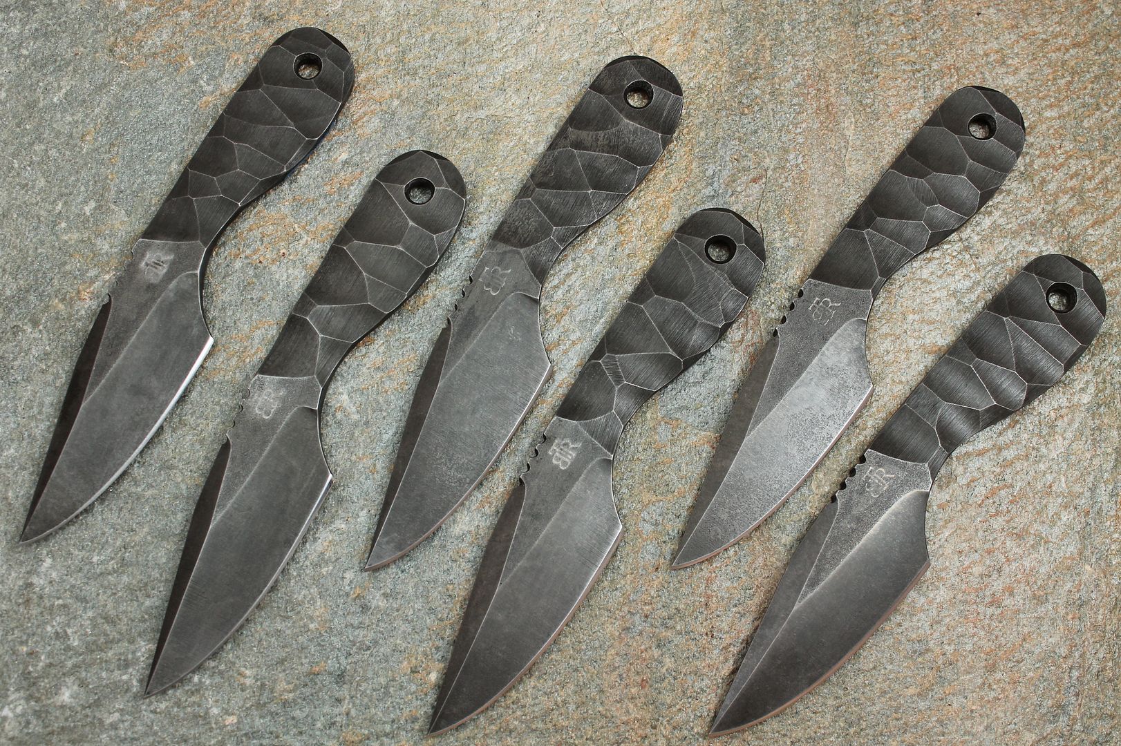

Here is where I am at right now. I am just waiting on an order of eyelets to come in so I can finish them all.

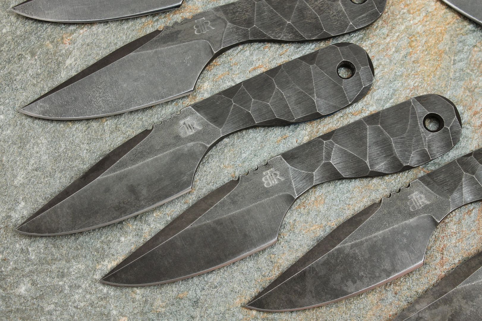

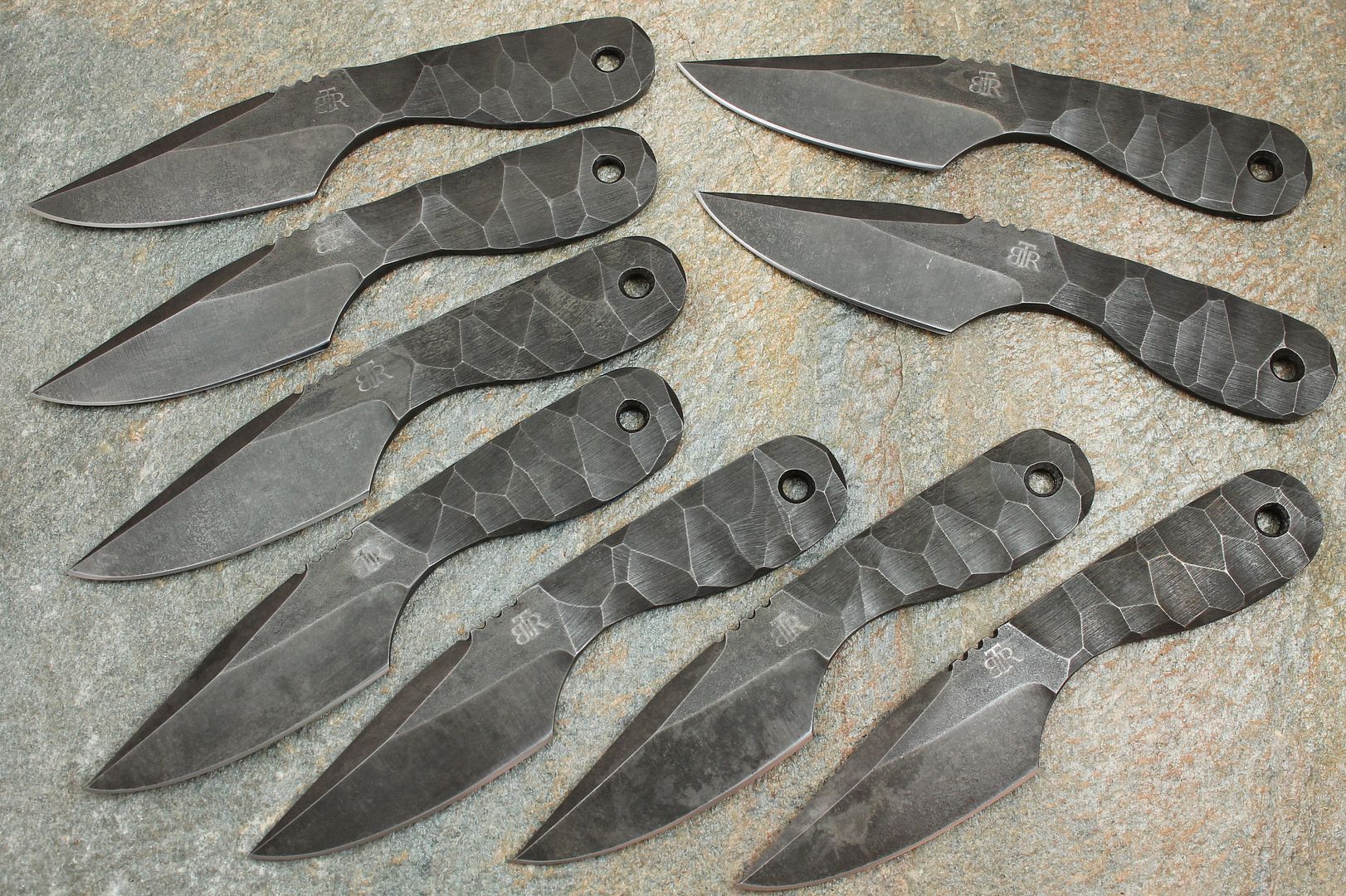

Acid etched and tumbled.
Here are some finished pics of the ones I still have. If my eyelets ever get here, I will finish the sheaths for them!
