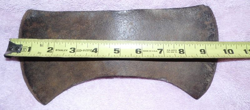

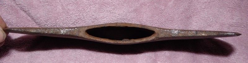

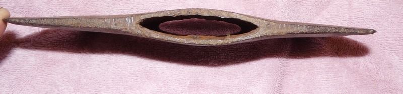

I recently bought this at a thrift store.
Specs are 55 ounces (3.44lbs), 10" length and 3" across the eye.
I cant find any stamps on it.
Is this one to re-handle and use or more of a collector?
Any ideas as to maker, pattern, age etc?
Thanks
It will make a good user. Michigan pattern. Not a collector piece, it's very common but looks like a good quality mid-twentieth century or earlier North American axe.
CowCop
Nice find. Your DB looks like a no-name Michigan pattern. With a little work it should make an excellent tool. Not a lot of value there but you should be very happy with it when you get it hung and sharpened. It probably needs a 32"-36" handle depending on your preference.
Good assessment. The geometry says vintage, too. Many no-name axes were made by big name makers and sold to distributors to add their own paper labels too. Probably a very fine axe but doesn't have collector value because it doesn't have a stamp. Perfect for a user! Clean it up, hang it and enjoy!
That's a diamond in the rough. Pick out a good handle for it, clean 'er up and hang it. Looks like somebody hit the edges with a grinder sometime in the past. A Nicholson Axe File and a whetstone are yer friends here.
