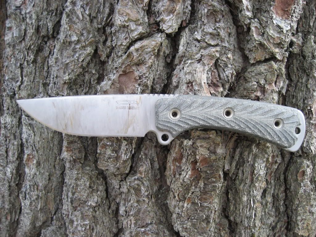

Here you go. I love the combo doublecut with black canvas.
Nice pic Al-Sheikh. I am not sure what knife you have? But I like it (modified team Gemini?).
that was going to be my guess. i really dig the way it looks too
Yup, it's a modded TG, a really cool one at that. He started a thread about it 3 months (?) ago....maybe :confused:
So, Al-Sheikh, have you thrown that TG yet? ;)
And that DC BM is sweet Guyon :thumbup:
Correct! A circumcised TG it is! I've thrown the beast like there's no tomorrow. Great fun :D
