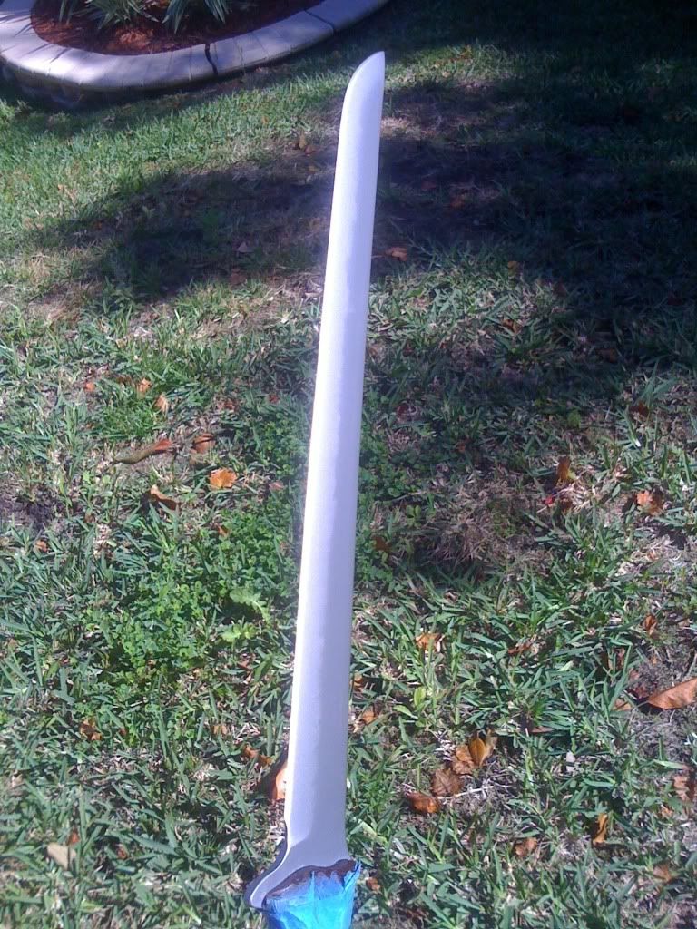

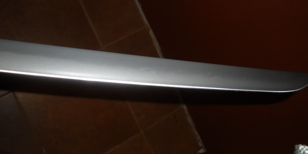

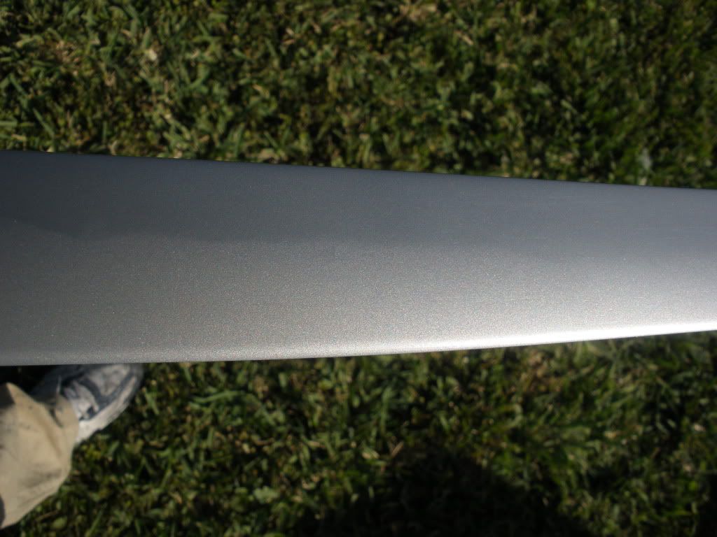

Figured I'd share my project The pictures aren't great, but I tired to show the temper line, which is really sweet
i'm confused. what does "double cut" mean? i see the temper line or hamon, is "double cut" just another term for differentially tempered? i was wondering why i couldn't see the hamon on the "satin waki", it's really cool to see it here.
also, what is that other skwiggly line? the one that starts at the handle and goes up about 3"? the one you can see really well in pic #4.

AFAIK, that is the first waki we've seen that displays the temper line.

And as for that other line, I have no idea, its a line of tiny triangles and was there before I did anything to the blade other than strip the coating with a chemical stripper and hand sand the grey undercoat off, its a mystery
Double cut is just another term for bead blast finish, it involves 2 different mediums (hence the Double I think) aluminum oxide and glass bead, the AO turns the metal a dark grey and very rough to the touch then the glass bead polishes it to a no reflective surface. as to why the temper line doesn't show on satin, I don't know, might be because its a very subtle temper line and the satin finish over powers it.
And as for that other line, I have no idea, its a line of tiny triangles and was there before I did anything to the blade other than strip the coating with a chemical stripper and hand sand the grey undercoat off, its a mystery, I need to get Eric to take a look. doesn't really bother me though
Interesting. I was expecting the temper line to be more uniform as they tend to be on some of the older rats. It looks like it was an actual mud paint procedure.
it looks like you covered the scales.... would the D/C process mess up the G10??
