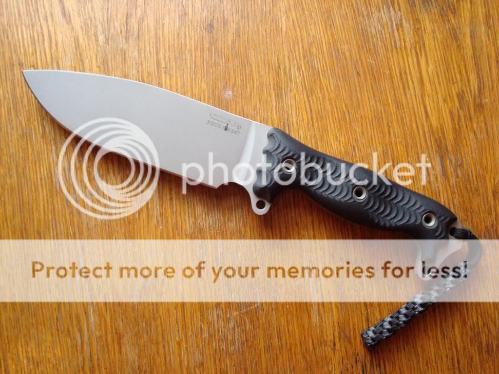

Here was one of my ASH's. I don't know if the pic's any better than MM's.
I prefer the double cut over the coated but satin is at the top. I think it all depends on what you want.
The only con I can think of is that it is more $ than the CG's.

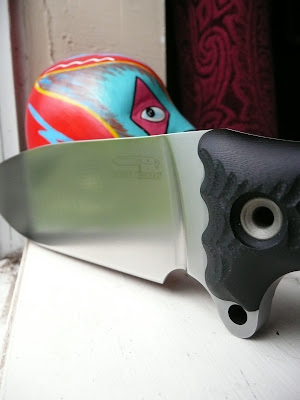

Just to drive home the point that the satin finish is absolutely a shiny finish, here's that same sjtac, outside on a cloudy day. Again, not the best picture, but it ought to show somewhat the difference that lighting can make in how a knife looks when you photograph it.
