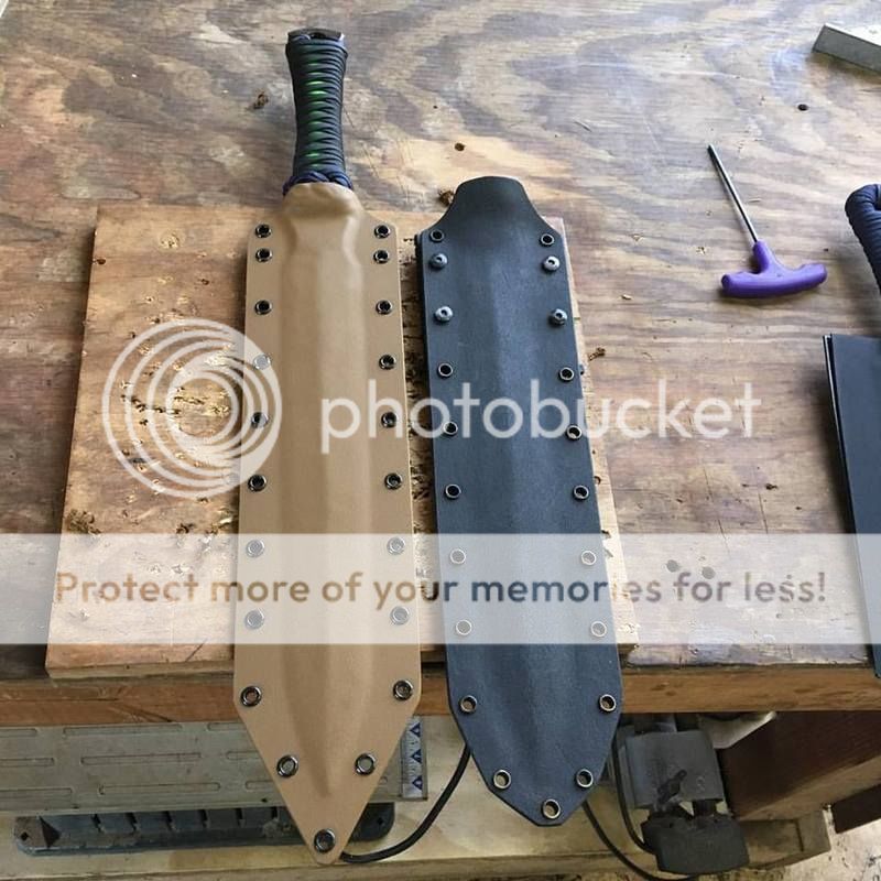

And the improved sheath molding is obvious. The original black one was done by heating about 6" of Kydex at a time with a heat gun. The new tan one was heated with a T-shirt press. The T-shirt press is one of the best tooling investments I've made.
