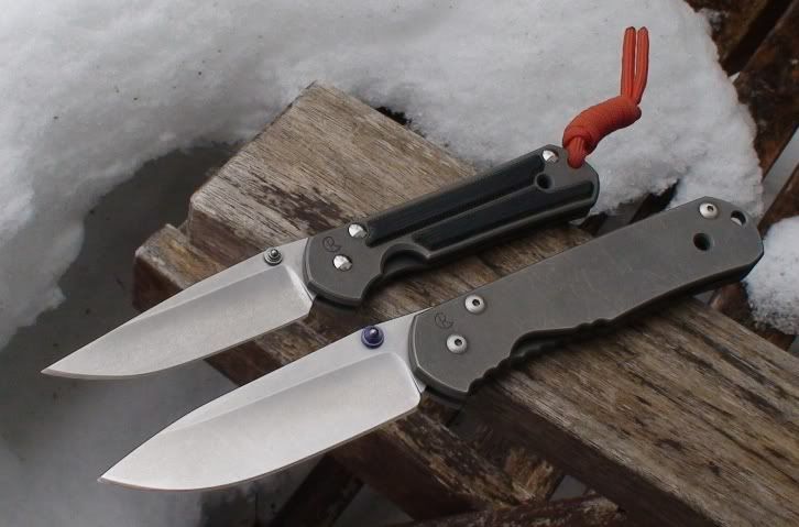

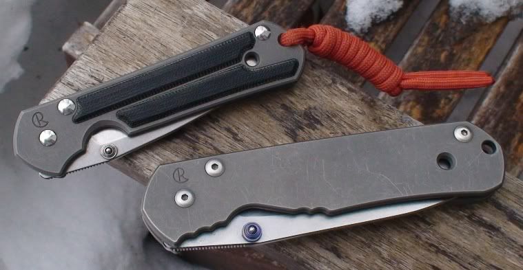

hopefully the owner of the pics won't mind, but it illustrates my question pretty well. how come on some models have the 2 small grooves cut on the outside of the lockbar in addition to the main larger ones on the underside. is this a design improvement over the other models. IIRC, i see it on some Classics but not all, and also on some 21's but not all?

The satin finish option is created by first sandblasting the handle slab, then rubbing the face, minus the lockbar, on a flat grit surface. That groove provides a break in the surface to provide clean demarcation of satin finish and sandblast finish.
Those grooves were made so that the pocket clip wouldn't bind on the pants pocket. It was before they changed to the new clip.
