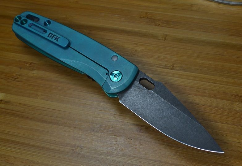

Double grind, stonewashed green anodizing, deep contouring on frames... oh yeah!
Here's some information on this one...
8.1" Total Length
4.6" Handle
3.5" Blade
.140" 6al4v Titanium Frames
.155" D2 Steel Blade
Ceramic Detent
Phosphor Bronze Washers
Titanium Pivot and Screws
Carbon Fiber Backspacer
Carved Ti DFK logo Clip
Double Hollow Grind!
Polished Microbevels
Emerald Green Stonewashed Anodized Frames and Clip
Acidwashed Blade
Incognito signature on frame inside
Carbidized Lock Bar Face

I need some better pics, these were done with a desk lamp and I just need more light. I think this is my best knife yet.
What did you use for the acid wash?
I was thinking of using a black oxidation kit on a few scrap designs I have and seeing how they turn out, but I'd like to know if there is something out there that might be better on the market. And, was wondering if anyone has used the oxidation kits.

Hi! I used diluted ferric chloride solution, it takes a little longer with D2 but still etches nicely. This etch is on the deeper side and was in the ferric chloride for a few cycles of about 45 seconds each time... rinse in boiling water then clean with dawn/toothbrush... windex.... reverse osmosis water then repeat.
Not too sure on the kit, do you have a link? Sounds cool! The Ferric Chloride is from Radio Shack but you can buy it online in powder form.

What made you switch to the double grind? Thought you were all about the chisel.
I am all about the chisel grind but like to mix things up from time to time. I am working on a new flipper design that will be ambidextrous and at least some of them will be double ground.
I personally think the chisel grind i tougher to get right. I am going to be doing a lot of new styles and embellishments this year though and want to do it all! :D
